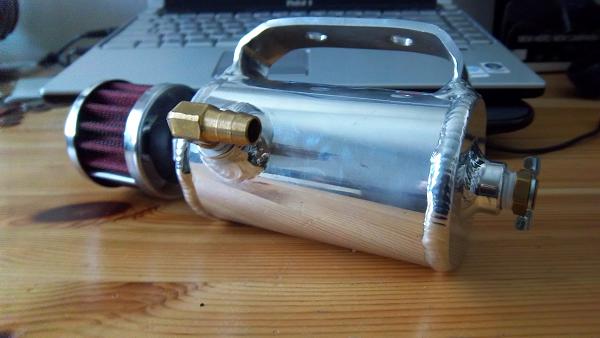

Yah but once we start to push then engine more then its design, more blow-by is created.

^ a guy is selling his on here that i just bought from him im picking it up tomorrow, picture above.

the jmf catch cans will do fine. is he giving u any lines with it? either way $55 is a good deal.
