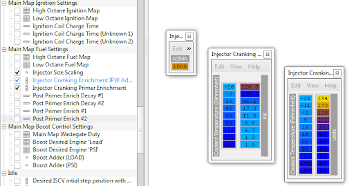

-Try these # in your main map fuel settings, Injector cranking enrichment ipw adder.
This is what works for mine. starts like stock even when cold. It is just the stock settings multiplied by .5
25.6 - 113
-0.4 - 54
17.6 - 23
44.6 - 8.5
68 - 7.7
93.2- 6.2
122- 3.3
170.6- 1.5
179.6- 1.5

You need an OBDII cable which you can obtain here: http://www.tactrix.com/ in order to re-flash the ECU yourself. It's also a good thing to have so you can log your car, clear CEL's etc.
Try these settings for your FIC 1050's:
With those settings on FIC 1050's and a single Walbro pump, car started fine every time, whether it was hot or cold
-Bink

Hey folks, i just got a set of 1050cc FIC injectors on and along with a tune ( first time with a set of injector bigger than 1000cc +). Is it common for these injectors to takes a couple of seconds to start the car when cold. I'm sure i'm not the only one but really want to know if it is supposed to be like this...Thanks guys.
Your more then welcome to bring the car back to let me make more changes. Like i told you last time you were here. its a tough thing to work on because it requires a flash, then wait to cool down, then flash, cool down, etc. You came on an extremely busy day.
For those following the thread. The issue is when the car is fully cooled. First attempt to start, car will take 2 extra seconds to turn over. If stock is crank crank crank start, this is crank crank crank crank crank start. once the car has fired up you can imediately turn it off and for every start after that, car fires immediately.
As with all other injectors a quick adjustment to ipw vs coolant temp cures it. I made some adjustments and let it cool. Wasnt enough to cure it. Made another and let cool, still not enough, and ran out of time for more changes.
Low trim was +1 and mid was +2 at the time.
Again, im more then willing to spend some more time with it, just get with me to set up a day to bring the car.
