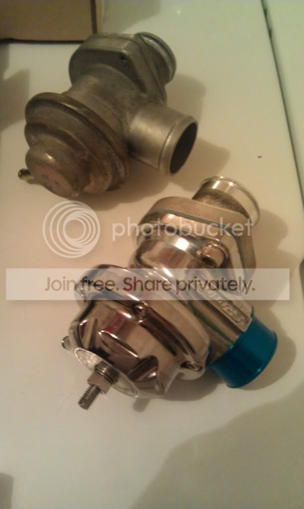

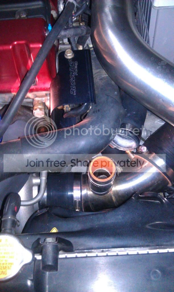

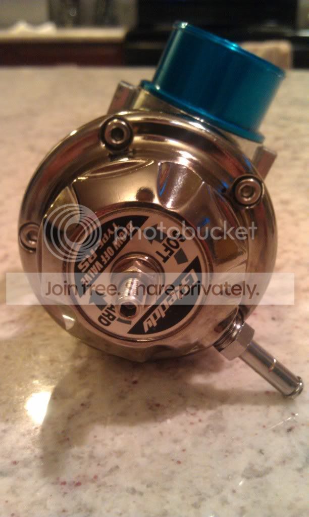

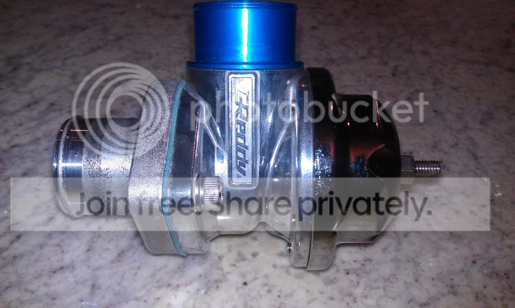

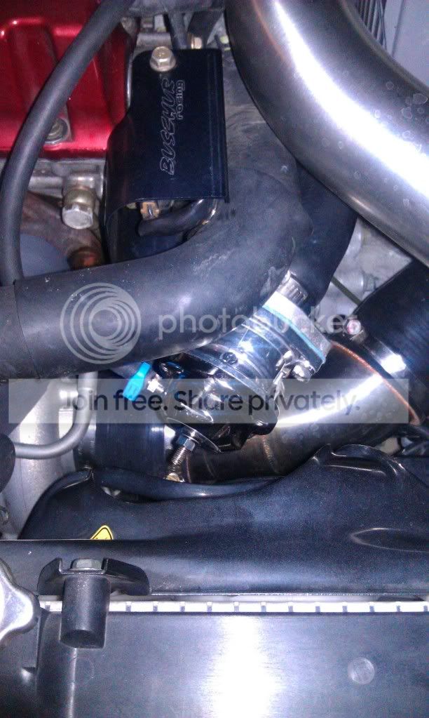

Got myself a new toy. Hopefully this resolves the issue of not holding boost.
~Chug

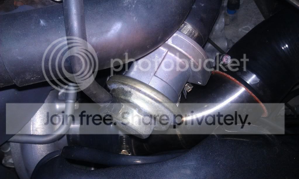

You're better off sticking with the OEM DV, that Greddy unit will eventually start to leak due to the ****ty diaphragms.
If you're not able to hold boost on the OEM DV, crush it and it'll hold better.
