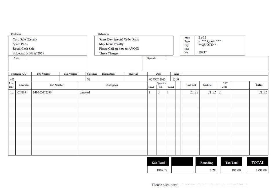

OK... So I called Mitsu yesterday and got a quote for parts.
Just for 2 belts, a few gaskets & water pump kit... $2000. WTF. Are they being serious!
Absolute p*ss take. I will be buying the water pump and belts from mitsu, totalling $600+, and pretty much forget the rest.
So the squeal in the video above, is the the auto-tensioner on the accessory belt. Would it be ok if I could get that aftermarket? Mitsu want $333.20 for just that.
Old Oct 6, 2011 | 03:16 PM
Evo8*'s Avatar
Joined: Sep 2011
Posts: 87
From: Sydney, Australia
Here is the quote they sent through. Is this unreasonable or not?
