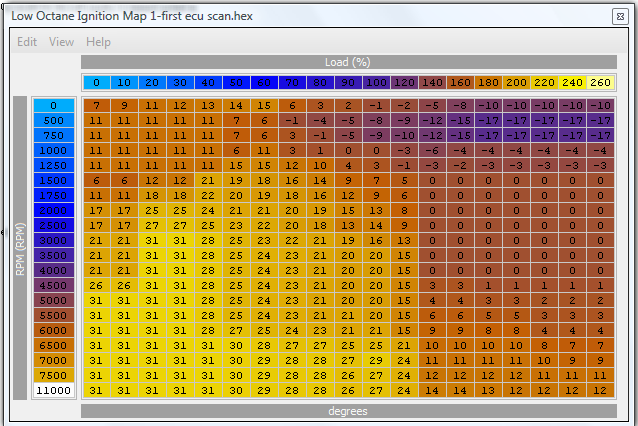

i just got a tactrix 2.0 and have no clue what anything s but i think this is what you asked for?

Oh yea I bet that's your problem. Look down to 1250 rpm and out to 40 load in your timing map. Those 18's are pretty far advanced.
My car would def throw a P0300 with that much idle timing.
I'm guessing this was doe to tune for cams???
