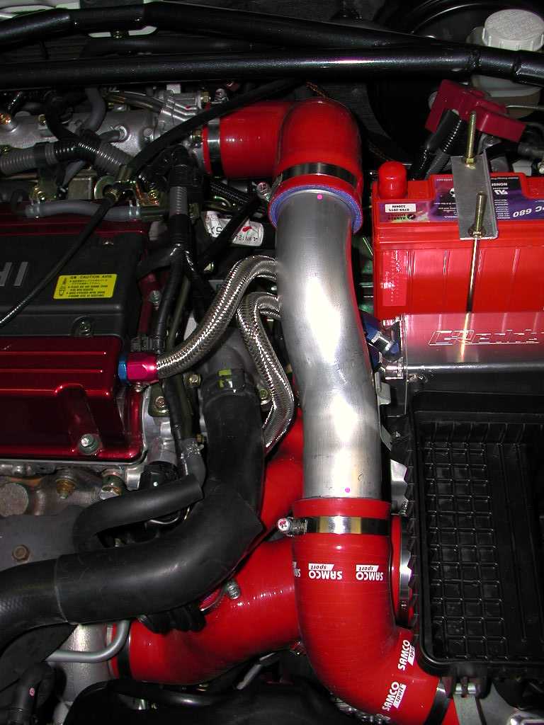

Well, I decided to pull the trigger and purchase the a Buschur Stage 3 kit for my Evo. For those that have been living under a rock, one of the components of this kit is a mini battery. The mini battery clears alot of space in the engine compartment, eliminates some weight from the front end and is a necessary prerequisite to install the upper I/C pipe.

Despite the complete lack of any sort of instructions or diagrams the installation is actually fairly simple, however you may find yourself making a few guesses here and there.
Obviously the first step is to remove the OEM battery and battery tray. If you've got the tools and you've replaced a bettery in the past, this process should take you less than 10 minutes. Installing the new aluminum "tray" is also simple, requiring the reuse of two of the bolts used on the OEM tray. Now is a good time to make sure that you've installed the hold down bolts in the new battery tray before you bolt it into place. Note: the new tray will not fit properly with the factory airbox in place. I haven't had a chance to fully noodle through the design but I think some simple modifications to the tray design would allow the kit to be installed without the airbox needing to be removed. However, I haven't installed my upper I/C pipe yet in order to validate my idea.
Once the battery tray is in place you can then mount the battery itself. After some fiddling and diddling you'll discover that the correct orientation is to have the positive (+) terminal of the battery towards the front of the car. The only reason for this is that the ground wire bolts to a grounding point on the strut tower. Ideally if the ground lead were long enough you could orient the postive terminal towards the firewall, eliminating the need to stretch the positive lead. Install the hold-down strap and secure it with the wing nuts. I skipped the washers provided since they were the wrong size. I'll use the proper size washers when I can get ahold of them. Since the battery is so snug gainst the electric box, you may have to push the battery away in order to spin the wing nut. Install the ground lead to the negative (-) terminal on the battery. I found that I had to really spread the connector wide open in order to get it to fit over the post. In my opinion the **** should just fit and it shouldn't take 15 minutes of fiddling and worrying if you're going to break the aluminum terminal clamp in the process.
Once I had the negative cable attached I next turned to getting the positive cable attached. This was literally a bit of a stretch. I found I had to remove any of the support brackets remaining after the removal of the OEM battery tray and massage the harness to get the slack needed to reach the terminal post. Once I got the slack I needed, the terminal clamp slid right on, go figure.

Personally if I were to do it over again AND if I had the time, I'd relocate the OEM battery to the trunk. The $225 price, while perhaps only marginally profitable for Buschur Racing and it's distributors, is a bit steep for what it gets you. The street price on the battery is ~$170. Add another $20 for the aluminum tray and you're up to $190. That doesn't leave much margin. Regardless, improved documentation, fit and finish (especially fit) would go a long way to improving the value proposition. In my case, the three to four hours of time saved justified the price paid. My time is valuable to me. If you're on a tight budget or have alot of free time on you hands, consider piecing your own mini battery or relocation kit together.

i got the diy small battery kit:
cheapest odyessy hawker pc680 (680 cca) - 74.59 + 10 shipping
http://www.sunnbattery.com/item.html...0&PRID=1292858
cheapest SAE terminals - 12.95 + ?? shipping
http://www.batterymart.com/battery.mv?p=ODY-3217-0006
modified stock plastic battery tray - $0
stock holddown bolts - $0
modified aluminium bracket from home depot - less than $3
end result, 25lb weight savings for around 100 bucks

Optima battery DIY for 100 bucks. It's roughly 8 degrees here now and the car still cranks.

I used the factory battery mount and cut it to fit the smaller one. I used tie-straps to hold the battrery in place. I cut small slits in the mount and fed the straps through them and secured the battery to the mount. The battery weighs 16 and the 2 tie-straps can hold at least 60. Slight movement but you realy have to move the thing by hand. I tossed the car around a bit when I was done. It isn't going anywhere.
