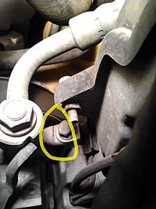

http://imgur.com/h9OKQ
Is this something I need to worry about?
Not sure what you guys use to upload pictures XD. Won't upload the picture from imgur. So just click the link!

Fixed

location? hard to tell from picture. how deep does it go? most cracks in suspension parts should not be ignored... recent wreck?

It's on of the mounting points on the power steering pump. Depending on how deep the crack is you definitely should get it fixed. If that bracket fails and causes the power steering pump to shift, you may lose your accessory belt.

Pretty much all the way through. Ack...there's soo much going wrong with my car right now and no matter what I do it doesn't let up...fml.

Yeah, this is the bracket that attaches the power steering pump to the side of the engine. As I remember, there are four bolts that mount the bracket to the engine. With this ear broken you have three remaining,
Pulling the pump is a bit of a pain but pulling the pump is part of a timing belt change so plenty of people have done it. You need a new bracket.
