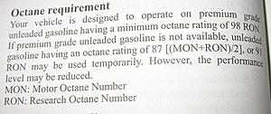

Here you go. I reread your original question.

If your dad was a *good* mechanic he'd know that higher octane in a high performance turbo engine won't harm anything. If you don't mod your engine you can get away with 91 octane. If you do anything to it, like raise boost or lean out the fuel you will detonate and the ECU will pull the timing to try and make it stop, causing a noticeable loss in performance.
As to your question, the US uses PON at the pumps (the P stands for "pump"). 91 RON = about 87 PON. Mitsubishi recommends 98 RON which equals about 94 PON.
MON = Motor Octane Number
RON = Research Octane Number
PON = Pump Octane Number, which is of course what you see listed at the gas pumps.
PON = (MON+RON/2)
