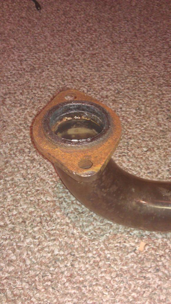

So i purchased a 3" DP off ebay, dont know what brand it is, and it doesnt bolt up to the oem o2 dump..........so here is where advices are needed, do i need to get a dump that fits, or maybe do some welding/cutting, let me know what ya guys think

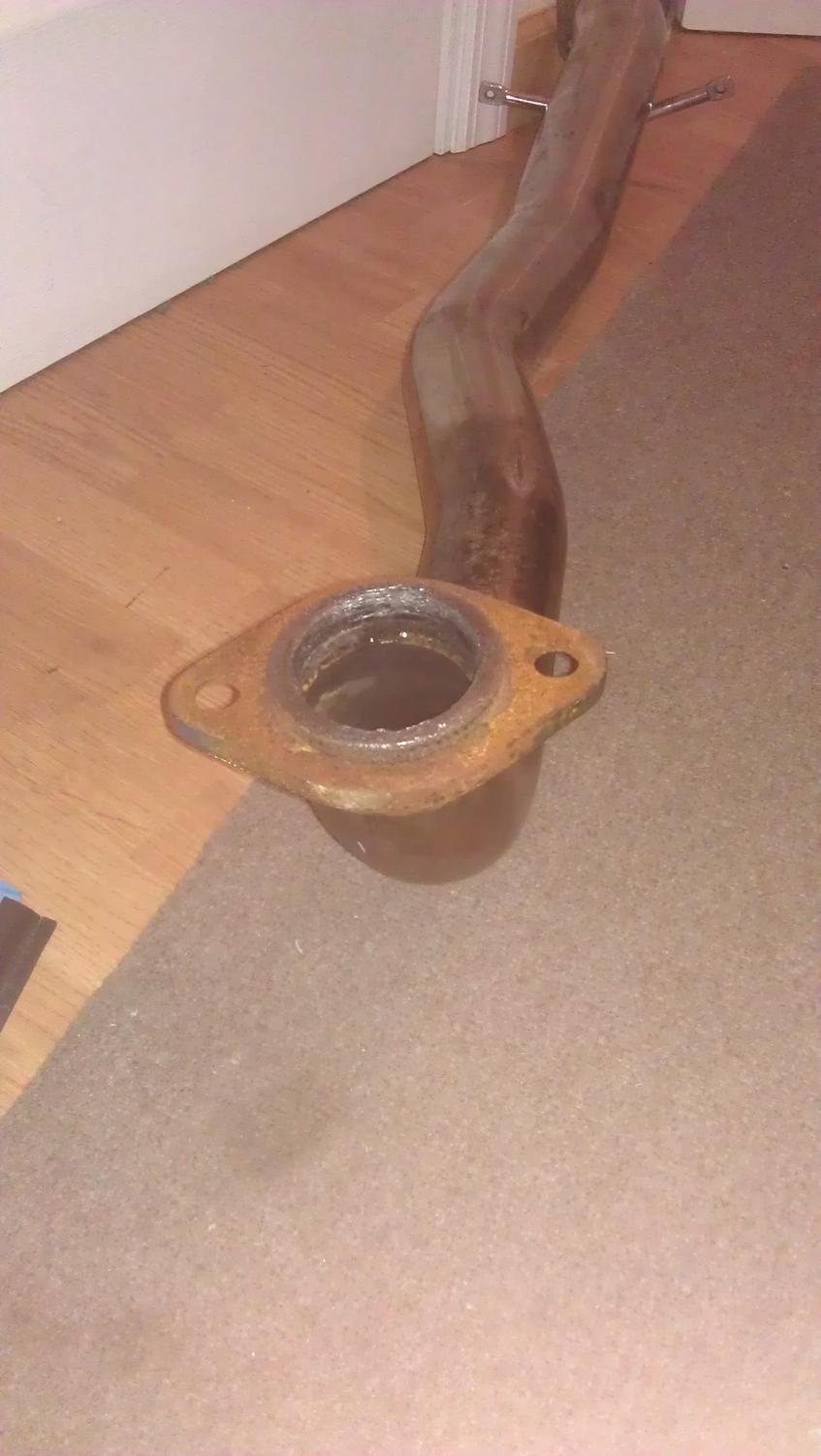

Heres a pic to have an idea
Attached Thumbnails DP doesnt fit! help-imag0392.jpg   DP doesnt fit! help-imag0394.jpg

Do you have the factory o2 housing installed?
I know it is impossible to gauge it solely on your picture however that downpipe you have looks like it should fit.
Can you explain where you are running into an issue? Are you having trouble getting the spring bolts to thread into the downpipe or it is hitting your oil pan transfer case or something like that?
Old Feb 24, 2013 | 05:13 PM
llDemonll's Avatar
iTrader: (21)
Joined: Jan 2011
Posts: 3,231
Likes: 99
From: Washington
that's an evo 8 downpipe, not an evo 9 downpipe
that's why it doesn't fit. it's not a matter of "****ty ebay parts" that don't fit like everyone seems to think, it's just that it's meant for the wrong generation evo
evo 9 downpipes have a much more pronounced bend so that they clear the ACD
that's a good example of how much more "bendy" evo 9 downpipes are

Very True about the Evo DP info.
OP never mentiond the generation Evo he was trying to bolt it up to just an FYI...regardless I don't see why people driving Evo's resort to eBay parts

um did you take the donute gasket off the O2 housing because it looks like another donut gasket is already in that dp....?
It fits everywhere else like the bend, and bolts right up to where the cat is...It just doesnt bolt up up to the 02 housing, and the 9 o2 housing tip caves in a little so the stock DP goes right over it...but this idk
