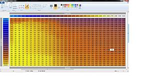

I cant seem to keep this car from knocking its driving me insane it wants lower timing but I don't want to keep lowering it. Not sure what the issue is
but here is tonights pull log and pic of timing map
is there something im missing? 26 pounds of boost
log and map uploaded

have you tried putting in high octane gas to see if its mechanical or true knock?

Knock sensors can read other things as knock, too. Have you made sure your exhaust is away from everything, and that it's true knock? Like, if you log without going into boost, is it still knocking past 3K? It also looks like you went way lean(18+) at log id 27.
* Note, I'm not that familiar with reading logs; the tuning forums, as suggested, will probably be a better place.

Are you logging knock voltage? This will help you differentiate between real and phantom knock. And you didn't specify as to when the car knocks. WOT? Part throttle?

Wot only,
Im trying to figure out how to tune partial open throttle when I enter boost around 5 psi it will hold 13.3 afr and slowly climb up and those areas are rich
