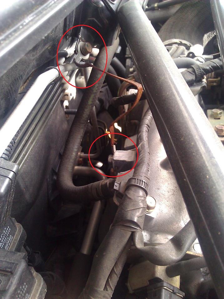

I was having the same issue (kinda). My temp would start rising randomly if I was at a still or moving. I checked the engine bay and saw a ground was no longer connected. I replaced the ground and now it doesn't overheat anymore. It's worth a check.
Attached Thumbnails temp rises when a/c is on full blast Help!!!!!!-wp_000454.jpg
Interesting...
