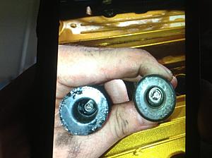

As you can see the Actual coil has this spring that just touches the sparkplug compared to the other boot that has the actual cup that snaps onto the sparkplug.

that's normal
the "main" coil bolts down to the valve cover securing it in place. the second coil just clips onto the top of the spark plug holding it in place
nothing weird about those
