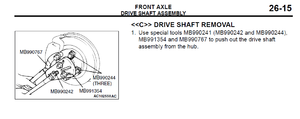

Special tool required
Originally Posted by brunz44
Any tips would be appreciated
you need a tool like MB991354 in the manual.
If you have one hand on MB990767 and the other hand on MB991354 how do you turn MB990242?

There's nothing to hold on the 991354
No hands on 991354 it's firmly attached to the hub which the 990767 in holding. It's the same tool that's used to remove the hub.
Attached Thumbnails Axle won't slide out-991354.jpg   Axle won't slide out-multi-purpose.jpg
