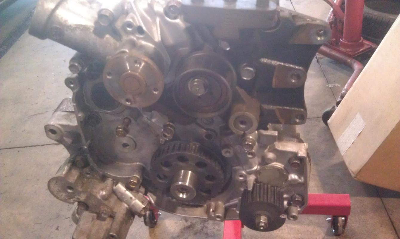

I have a pretty extensive trade offer going on with a local evo owner.
He had the engine and head in his 03' evo taken out and built by buschur. The head and engine have 0 miles on them.
Engine:
- 2L bored .20 over
- line honed with arp mains
- fully cleaned/surfaced/painted
- balance shaft delete
- weisco 10.5:1 coated pistons with asymmetrical skirts
- k1 stock length rods
- balanced and polished crank
- acl bearings all around
Head:
- ported
- flattened (lightly decked)
- 5 angle valve grind
- bronze guides
- black nitride coated super tech valves (stock size)
- kiggly beehive springs and ti retainers
- bc 272's (will be changed to s3's shortly after purchase)
- H11 head studs
- ARP cam bolts
- new OEM intake and exhaust studs
- new OEM head gasket
- new OEM timing belt
- water pump has 5000 miles on it
Also included:
- quartermaster 8 leg gear drive twin with hydraulic tob (200 miles on it)
- buschur double pumper with (2) walboro 255's (1000 miles on it)
As if that's not enough:
- Shep 'Ultimate Ratio Trans' (200 miles on it)
- Shep stage 1 t-case (200 miles on it)
The engine, head, t-case, and trans had 80k miles on them before rebuild.
So the deal is that he wants $5k plus my stock engine, stock trans, stock t-case, stock clutch, and stock fuel pump all with 44k miles on them.
He wants to put his car back to stock so he can sell it.
So, okay deal, good deal, steal, or no deal?

So, I did it. The engine, trans, and t-case are in my garage now.
Some things I've noticed, and I'm just looking for some insight from the community:
- The water pump is not new. It has 5k miles on it. Should i replace it anyways?
- The idler pulley has 12k miles on it. Replace?
- Stock cam gears on BR 272's, is there any real advantage to aftermarket cam gears if I don't plan on mechanically adjusting timing at this point?
Anything else I should look at / check / replace before I actually do the swap?
