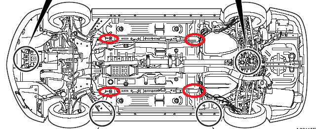

I have never used the pinch rails. I use the frame, like shown below:
My garage is slightly slanted but it's always sitting on all 4 stands.

I use these guys so I don't think I can see the gap you're talking about, Kyoo:
I have left the car sitting on the frame rails for a few weeks before without issue as well.
I only ever jack by the rear diff and the front tow hook or jacking pad on the sub-frame.
