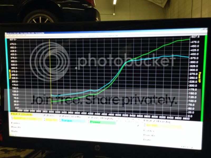

I'm at 502whp on a Precision 5857 on straight 91 pump gas. I don't know why people say, "Waste the money on a T3 setup". I paid less for my complete hot parts kit and 5857 than a new FP turbo. $2,500 just for a turbo is absolutely ridiculous. 500whp is easy to get.
Mine-
Kelford 272s
Buschur race core
Buschur I/C piping
Buschur SD catback
Precision 5857 DBB
Bosch 990cc injectors
SpoolinUP C.O.P.
That's it. 502whp on pump and 587 on 100 octane. We made 607 with 100 octane but backed it down a bit to guarantee no knock.
Sorry for the crappy pics, all I have right now.
