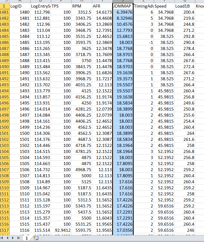

hey guys i need a little help.
i just installed an omni 4 bar map and logged a quick pull and i was surprised by the big difference.
by my boost gauge, i am right around 25psi, but on my quick pull i only logged 19 psi. my boost gauge is t ed in at the fpr vacuum line. my vacuum is generally between 12-15.
my concern is that the omni is off because i think the load reflects the boost that my gauge shows
car: 05 evo 8
my mods:
evo 9 turbo
upper and lower ic pipes
tbe
o2 housing
injen intake
hks ssqv recirc
tephra v7 96530706
here is a screen shot of my log
as you can see, at 3500 i hit full boost, load is at 290 and the map sensor is only showing 18
