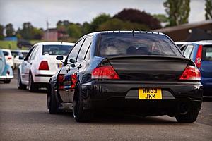

Can someone tell me what front fenders these are???

looks like spaced out oem fenders

Anyone know how to do that?

search "evo dave fender mod" and you should find it

Don't buy a kit or anything like that.
Get a piece of aluminum or ss.
Needs to be an 1/2 inch wide 1/8 inch thick and youll need at least 6 inches of material.
Cut it in half and put them in a vice or clamp them to a solid surface.
Drill 4 evenly spaced holes.
Then buy an inch 1/2inch long bolt like an m10 with a lock washer and nut. (2 of each)
Once side will bolt into the actual car with the oem
Bolt. The other will bolt to the fender.
Keep in mind you can crack your paint if you go too crazy
