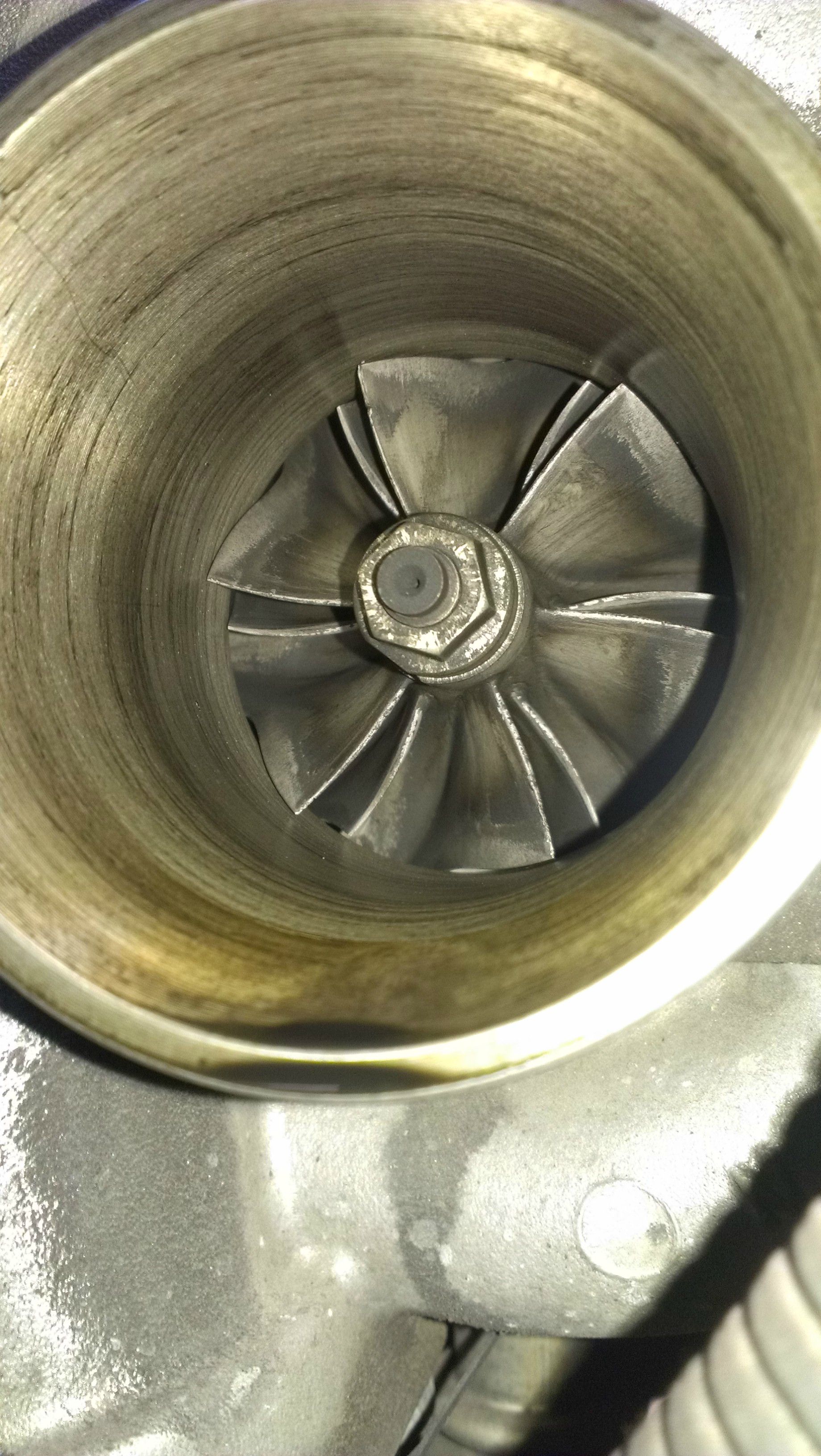

Got the intake off. Here is a picture of the housing.
It didnt feel like there was that much play in the shaft

My IX turbo and the rebuilt TD05HR 20g I currently have were smooth in the compressor neck. That looks weird to me like there are a bunch of lines in the casting. Maybe that's normal on a VIII turbo but I've never seen an VIII turbo in person so who knows, to my knowledge the only difference should be the larger hotside. If you can spin the shaft and its not scraping you're all good on that front. Try maybe pushing what little shaft play you have in one direction while you are spinning it to see of it makes contact with the housing. That noise still sounds valvetrain related to me though. And now you have to wait for the starter until you can tackle the other issue. I'm wondering now though if the noise was your starter solenoid not disengaging after the car was started. Like the flywheel was dragging the starter along "for the ride". That would be ****, two birds one stone, and you're back in business. good luck and keep us updated.
