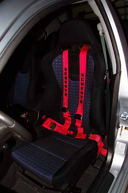

I just posted this pic of my Schroth Rallye harness. I purchased it on eBay from a guy who had it in his BMW 3-series to go into my 2000 Celica GT-S. As you can see, it goes into the Evo w/little trouble. If you get one meant for the Evo you might have a bit different flanges at the bolts for fitment, but, again, I didn't have any real problems.
The harness is comprised of two main parts. The chest and lap straps are one part (at least they were assembled when I got mine used) and the rear, 'anchoring' part.
The 'anchoring' part is a single strap w/2 flanges, one on each end, that get bolted in right where the rear seatbelt anchors are located. Simply removed the rear seat, unbolt the anchors with your socket wrench, and bolt this back in place, making sure there are no twists in the strap. In the center of this strap is a clip that looks like the male end of a seatbelt - a blade with a hole in it. This will clip into it's female counterpart on the chest and lap straps part.
This chest and lap straps part must have the flanged ends guided and shoved through the holes in our recaros. Again, this is what I had to do because everything was already assembled - I don't know how many pieces the harness ships in prior to assembly, if any. Once slid through you have the hardest part - bolting the flanges into the seatbelt anchoring bolts for the front seat. They are ON the seat itself on the console side - a bit odd when I saw that. That can be awkward but it's certainly straightforward. Just unbolt, place the strap flange or anchor and rebolt. You have to make up your mind whether you want it inside the seatbelt itself or outside and mind the washers so all is assembled their best. Just watch how it comes apart and what all comes off so it can all go back on logically!
Loosen the straps, clip the back part to the front, slide in, clip it together, and pull on the tightening straps - boom! You're in!
I assume larger people may have fitment issues and it's important they get the proper part. Calling the mfr of a harness and telling them what it's for should get you some insight - even if you're buying it from a private party.
Good luck!

Is that instulation prettymuch perminent? It does not appear that you can uninstall it very quickly or easily? Do you wear the harness for evey day driving then?
I do not have a roll cage and I am looking for something that I can put in for autocross events/track days and taken out for normal driving or something that I can leave in but be able to use the stock belts as well.
