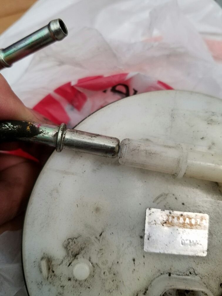

Not pretty but I found this after searching. You will have to use a short length of stock rubber return to clamp on the housing. Find the male side of the QD and use it between the lines.

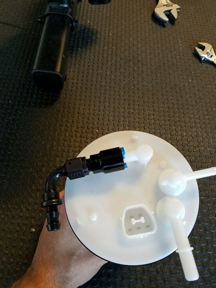

If you plan to use the stock output nozzle on the oem fuel pump housing for a single pump setup, but still want to upgrade your fuel lines, you need a 3/8" ID SAE to -6AN quick disconnect fitting and mate it to a 90 degree -6AN fitting like so. As you can see i'm using AQP socket less hoses for the end portion:

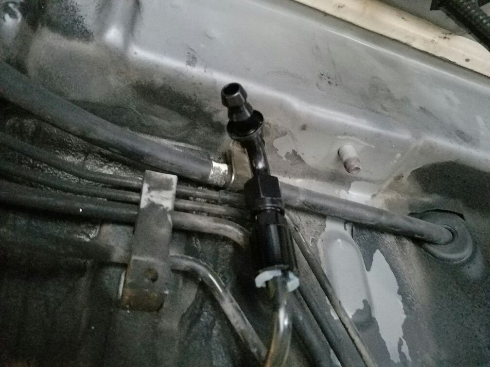

For that to connect to the fuel feed hard line (which goes all the way to the fuel rail) under the car, you will need a 5/16" ID SAE to -6AN quick disconnect fitting underneath the car. Here, I also chose to mate it to a 90 degree -6AN fitting right off the hard line to follow stock route configuration.

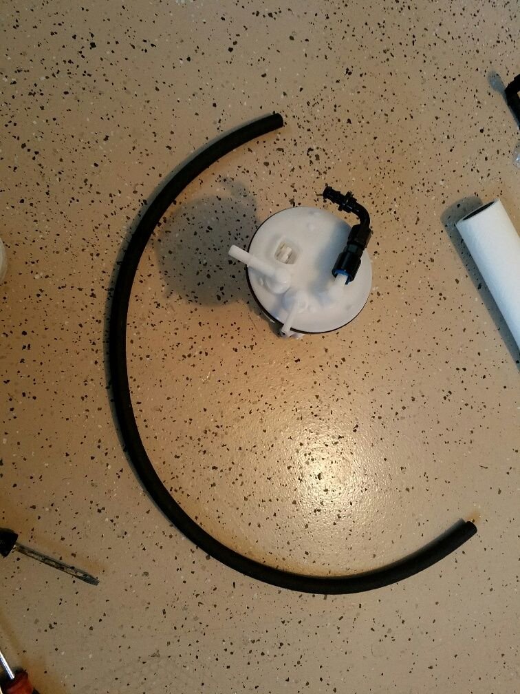

-6AN hose next to new fuel pump housing modified for Walbro 450LPH
Shows the difference in size
