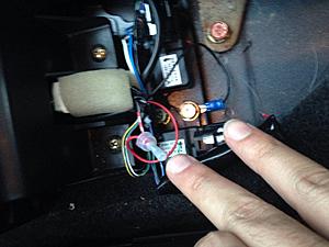

I just changed to a butt connector cause my t-tap for my power wasn't really working. It's better now but the only thing is that under boost it still shows dashes
