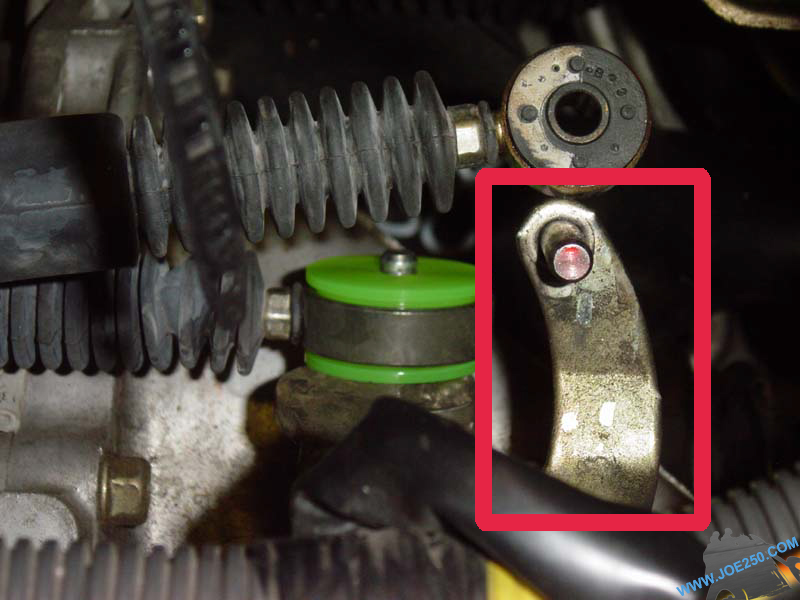

Im looking for the actual name of this part and the easiest way to get a replacement. Any help would be great! Thank you

The part name is " select lever " ( # 5 ) It bolts on to the " control housing " ( # 13 )
Sorry the workshop manual doesn't give many part numbers.
I'd at least start by showing a mitsi dealer these photos hoping they might be able to get it for you, or at least point you in the right direction.
Some evo workshops might even have a crap gearbox you can source one off .

If you're good with metal work, it's not too hard to make one up. Essentially it moves the control housing lever in and out via a pivot point, and only bolts to the control housing as a mounting point. It doesn't go into the gearbox like the control housing lever does.

Thanks for the info! I called my mitsu dealer and i think they ordered the right thing for me. If not Ill just have to walk in and show them that diagram. I really appreciate it!
