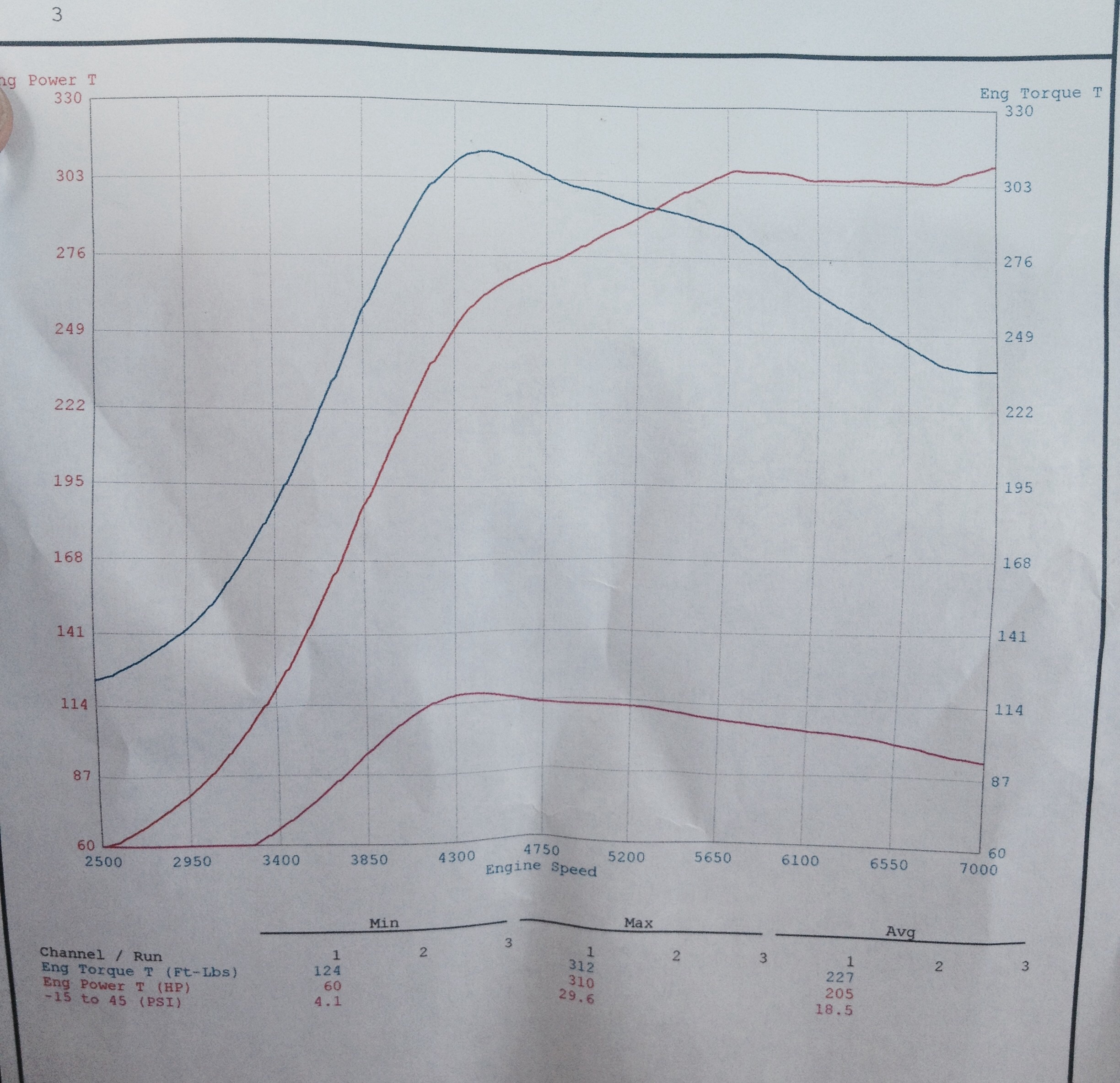

Let me rephrase this. Im on stock turbo 28 psi spike then obviously it bleeds off up top. Here is the dyno sheet. Boost is red line at the bottom. Looks like 29 psi spike actually.

You could still have a boost leak, among other things.
I'd test it and go from there. Are your AFRs okay?

I guess I cant say for sure. The graph doesnt have afr. I dont have evoscan.
