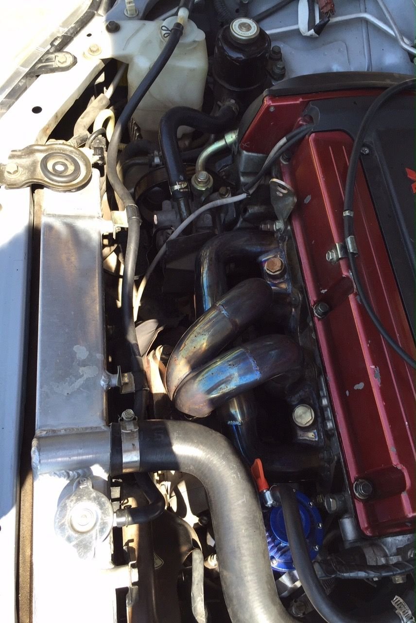

well i talked to the guy(kid) who bought it a month ago and can no longer afford it and gave me the # of the guy he got it from and it has wisco pistons,eagle rods,brian crower +3 cams,1300cc injectors,new balancing shaft an pulleys w/cam sensor.

Evo 10 turbo? Doubt it.

the evo 10 turbos r to big? sorry i am a honda guy and i just sold my car to get a evo so i am new to all this

An evo 10 turbo would never bolt up to an 8/9. They're very different turbos. The size isn't the issue, they're similar sized. Just look at a picture of a stock 10 turbo vs a picture of a stock 8/9 turbo and you'll see why that would not work.

probably meant an IX turbo, which is pretty common. I wonder what about it he couldn't afford if it doesn't need work.

That orange plastic by the hose clamp (for the BOV) will get burned up the first time the manifold get hot.

Evo ix turbo would
Make more sense, but with all those upgraded internals (and the what they cost) I am surprise the turbo is not bigger. My stock ix is getting an fp green installed right now.
