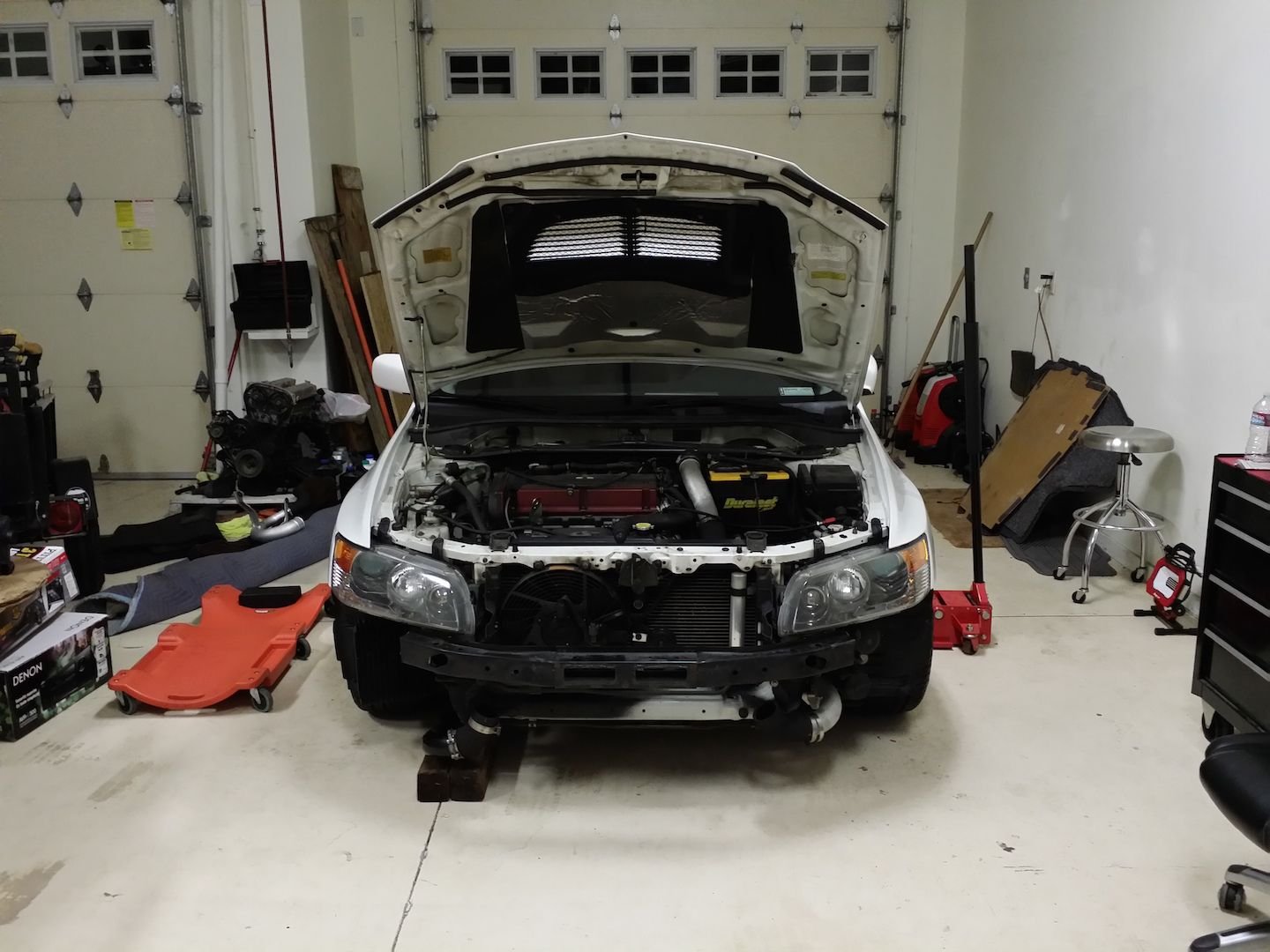

I have started the teardown in anticipation of the new mods arriving.
The front bumper, undertray, and intercooler removed.
The stock airbox removed.
