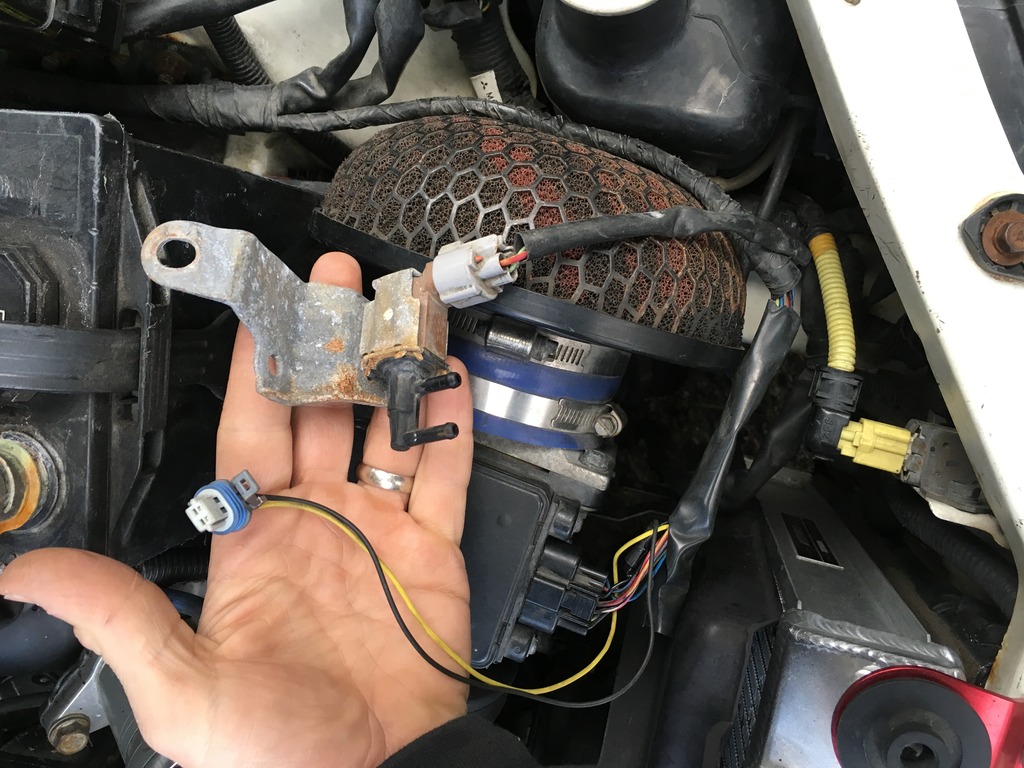

There are two wires tapped off the maf that look like they plug into the inter cooler piping but arnt long enough to reach. I think I had somthing like that on my 1g for a tuner. Anyone know if u need it.

2 wires off mass and boost cont?

2 wires off mass and stock boost cont ?
