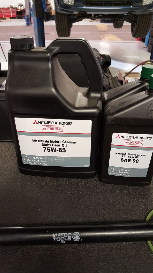

I had our parts department order me some trans fluid for my Evo 9, 5 speed. And I was given this.

The big bottle is for the transmission. The smaller bottles are for the transfer case and the rear diff.

Oh yeah I knoe, my question was actually that, if it was correct fluid it said it's for 6 speed but the parts department at Mitsubishi said it's the right one for both. Wasn't sure.

Both the 5 speed and the 6 speed use the same OEM transmission fluid
