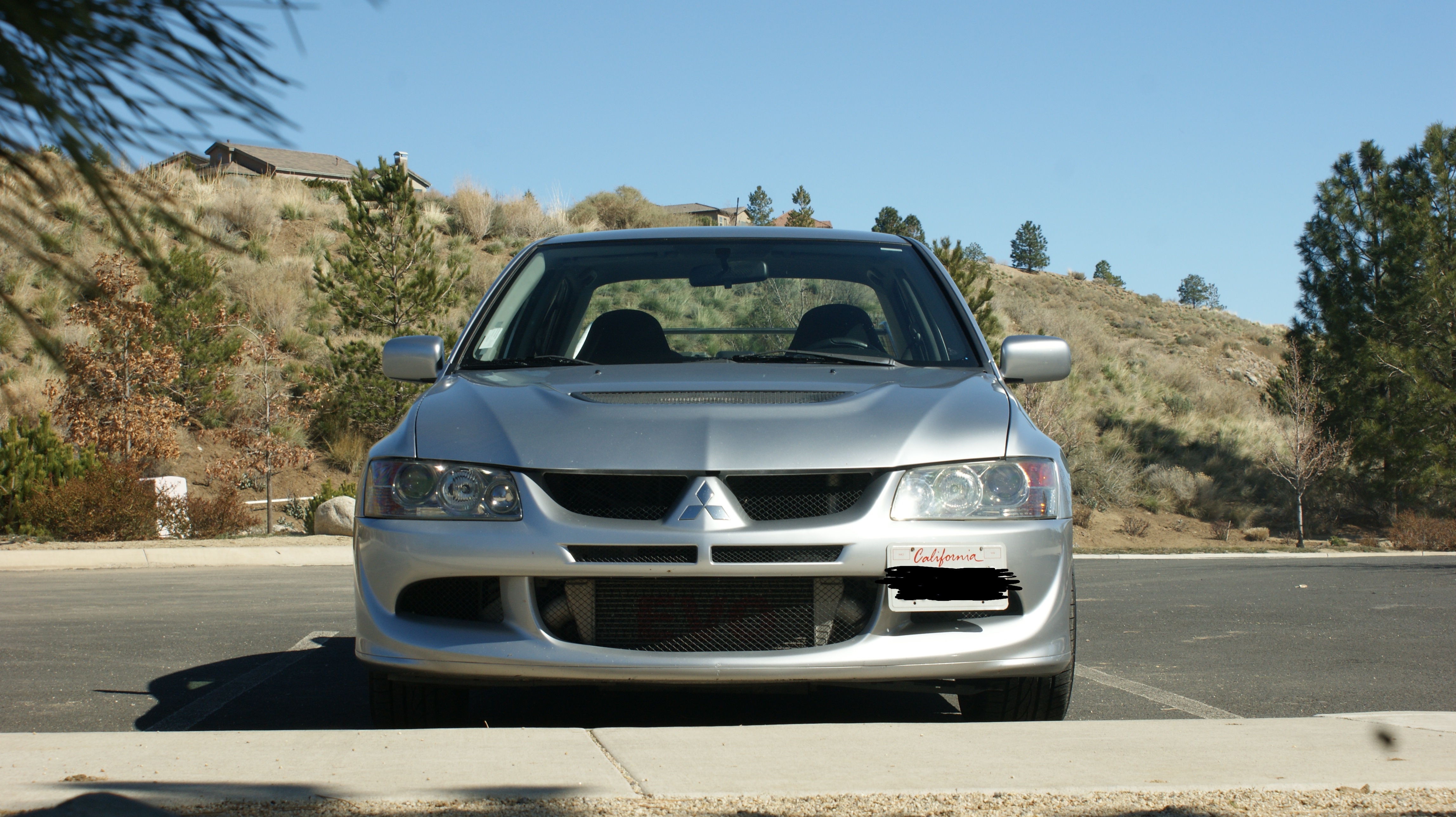

So I just purchased a VIII Evo and the owner before me spray painted "Evo" on the ****ing intercooler and completely ruined the look and disrespected the car imo, does anyone know what I can do to either remove the paint or paint a nice silver coat over it to cover it up. Here is a picture I had on my computer from the front of the car showing the intercooler. Any help and options would be great

If I was you, I'd remove the intercooler and use a paint stripper

Go to a parts store and get aircraft paint stripper, use a spray bottle, spray over the painted area, let it soak then pressure was the intercooler. Should take care of it pretty easily.

Paint thinner or acetone .

or buy another stock FMIC, I've seen them sell for $50

if you're going to take the fmic off to paint it, paint it silver. Or you could just buy a nice kit from vrsp, depending if its stock or not

Do you plan on modifying your evo? If so, now is the time to pickup a new intercooler. It's going to be a ton of work to strip the paint off your old intercooler and chances are you're going to have paint between the fins that you can't get to.

Air craft stripper

I would just upgrade or buy a stock one for cheap and get rid of the painted one

like stated i used a aerosol stripper to get the ets off my intercooler. I took the bumper off went to a car wash and sprayed it down let it sit for 5 min then power washed it right off.

Normal Paints will also reduce the effectiveness of transferring heat from the IC to the air.
