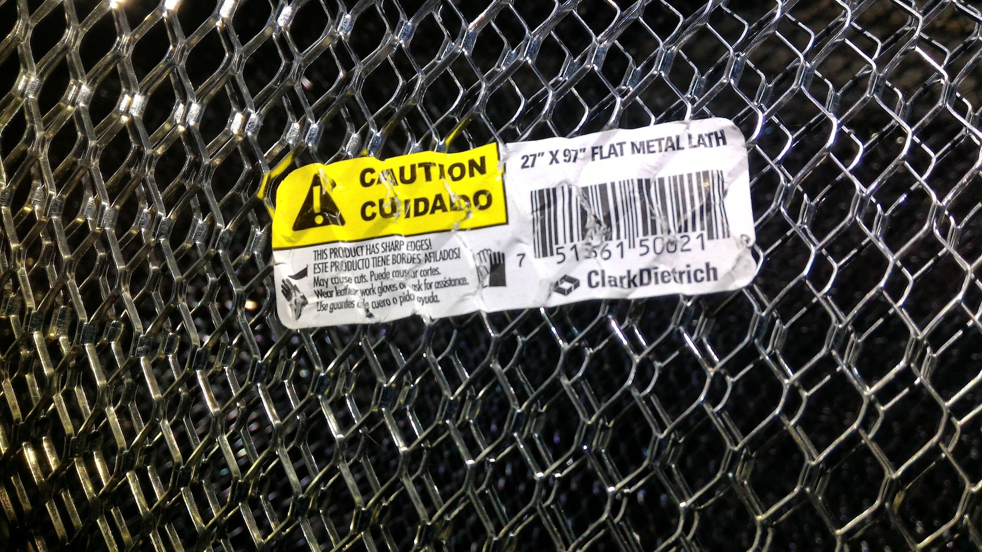

homedepot has a sheet you can buy for under $6 that will work....
http://www.homedepot.com/p/27-in-x-8...ord=metal+lath
spray this sheet black if you want and mount it... what i did
i used this on my lancer and works just fine. only issue i had is tabs on my replica evo7 bumper made for my oz rally broke off, so i just poprivited it inplace lol
if your uneasy about quality,, its very durable.. head down to HD and check it out before you buy it witch is what i did....

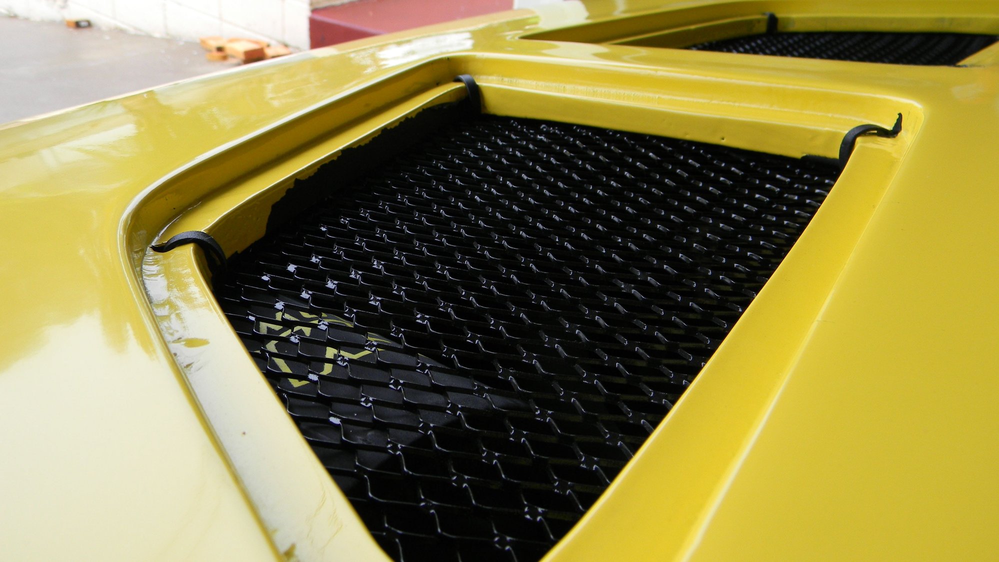

here is shot of one on my hood and closeup of the roll.. in this situation, zip ties worked for me lol

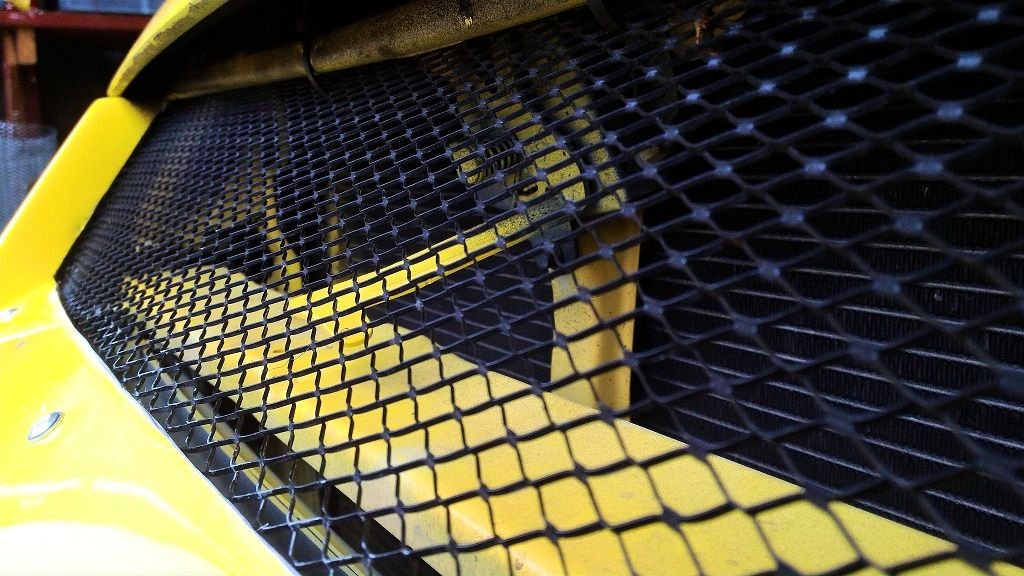

Closeup of bumper part, ignore the dirty part lol.. hope these images helps....
the material is strong and bendable so u can make it fit to contur of the inside of the bumper

please dont buy the chicken wire from home depot, it looks cheap no matter what.

its not cheap by far. its flexible and strong...
my case i had no choice as i dont have what came with bumper no more...
at $6 worth the risk . whats it gonna hurt, you'r ( im ) out of a 6-pack of beer
