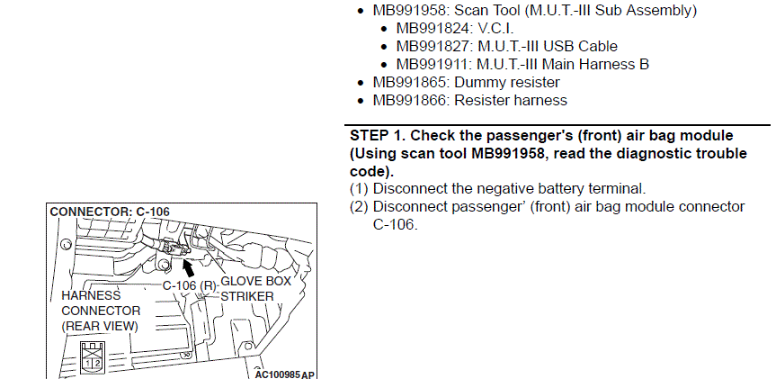

  #41
Originally Posted by StreetLethal
So has anyone had the airbag actually go off? I live 70 miles plus to the nearest mitsu dealership with 650+ WHP lol. So im skeptical driving that far to begin with..and seeing the bad stories of damage done etc.
Take the 10 minutes needed & disconnect the passenger side air bag. Just make sure you disconnect the battery
Remove the glove box & the connection can be seen & disconnected
