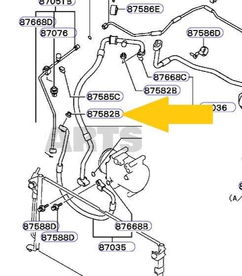

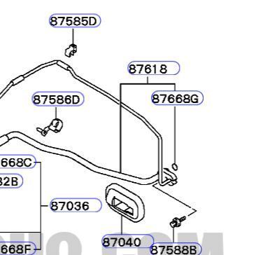

Does anyone know the bolt size that goes into the air conditioning lines that hold them into the firewall?
Attached Thumbnails Bolt Size Question - Air Condition Lines Firewall-screen-shot-2016-05-30-2.21.31-pm.png
Old May 30, 2016 | 12:52 PM
If youre referring to the single bolt that holds both lines in, looks like item no.87588 which is part no. MF243628 (M6x25)
That's it. Thank you!

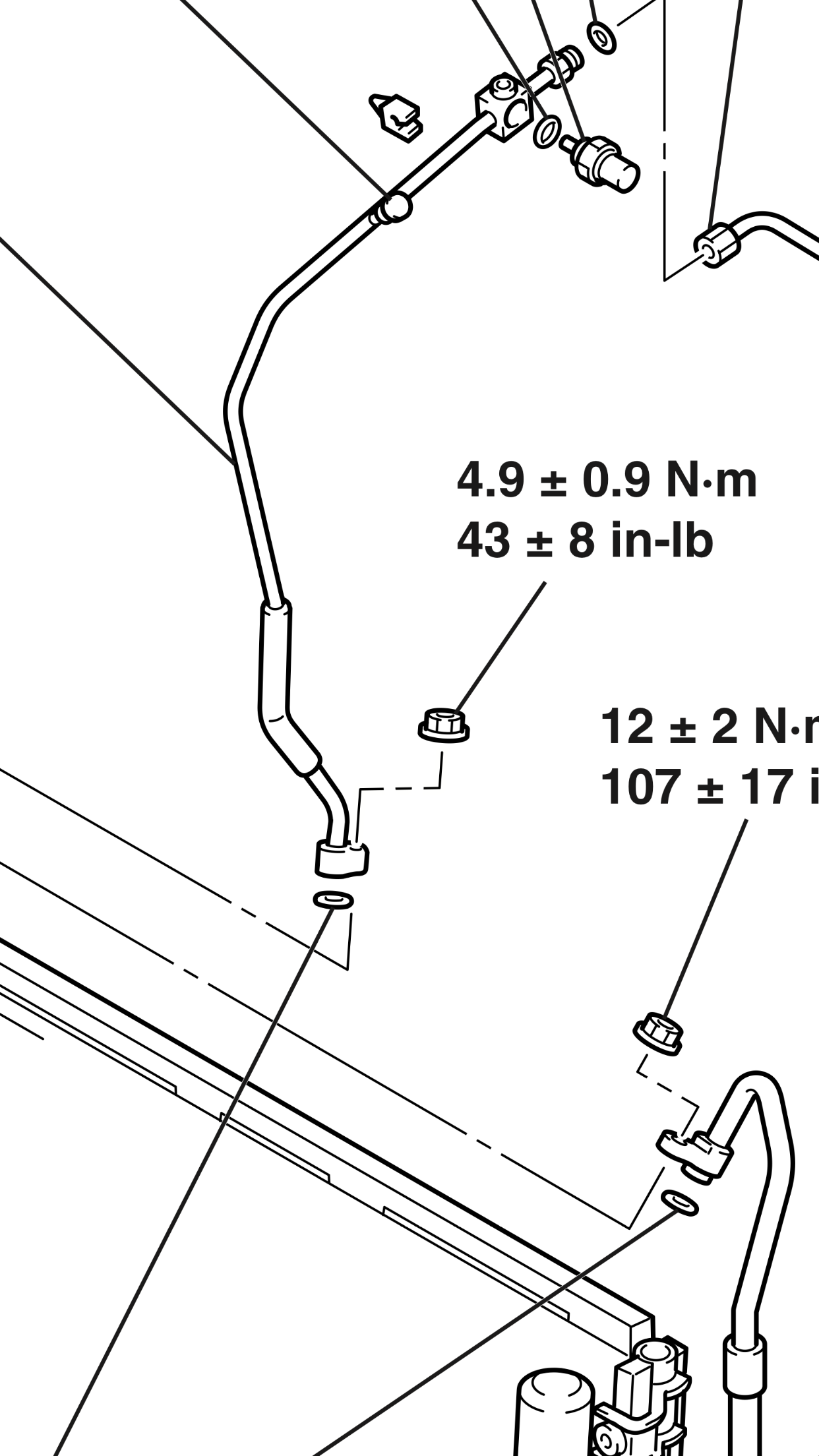

Does anyone know what nut size I need? I lost one of the nuts.
Old Jun 19, 2016 | 08:49 AM
05EV08's Avatar
Joined: Sep 2014
Posts: 164
Likes: 8
From: USA
See attached picture
Attached Thumbnails Bolt Size Question - Air Condition Lines Firewall-image.png
Old Jun 19, 2016 | 01:47 PM
Looks like an M6 nut w/attached washer / Part no. MS440502
