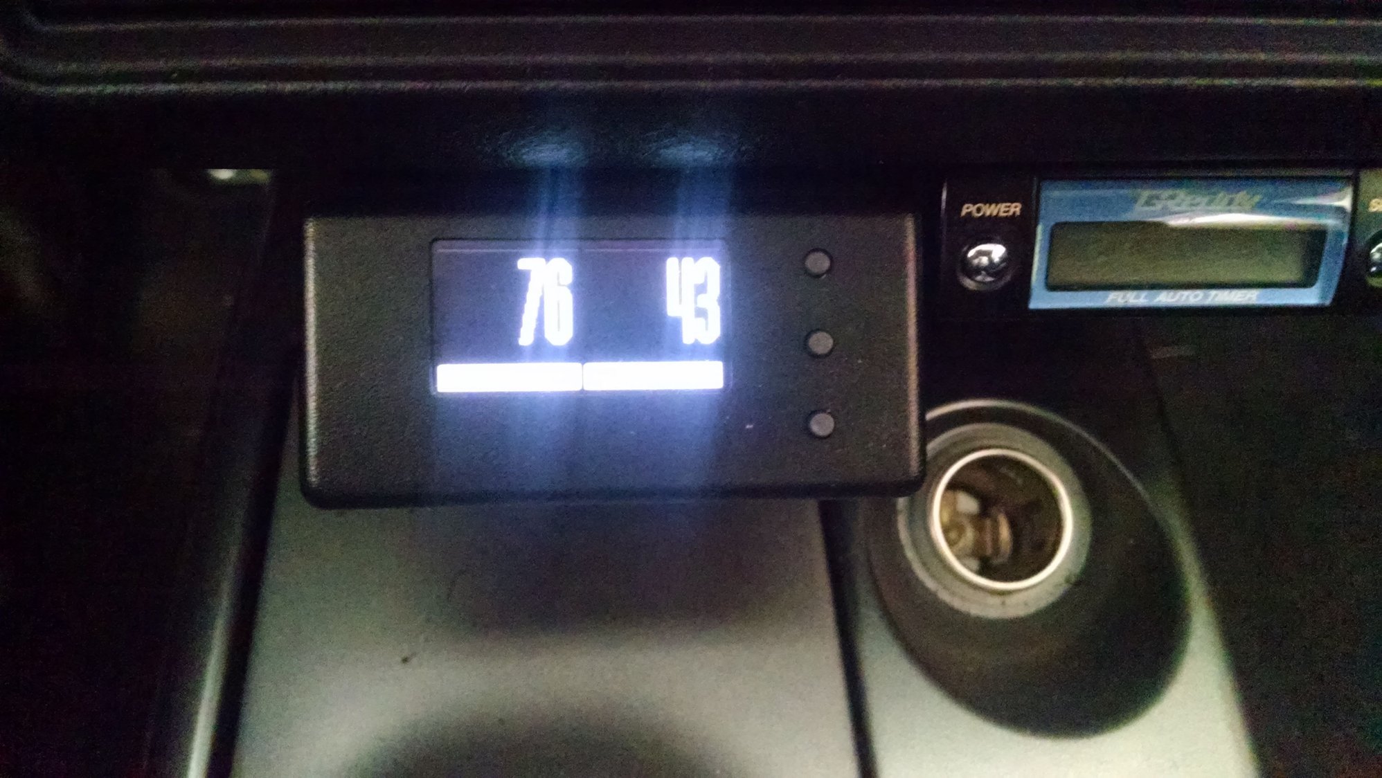

Sorry it took an extra day to get some pictures; work has been busy as hell. If you have any questions about what is there let me know.
****ty picture of the display. it looks better in person. ethanol content on the left and fuel temp (in C) on the right
top view of the sensor mounted to my firewall. I made the lines at the auto parts store. They are GM 3/8" push-loc's
convertor box mounted in behind my glovebox. One wire to the ecu, 12v constant, 12v switched, ground, a harness to the sensor and a harness to the display.
