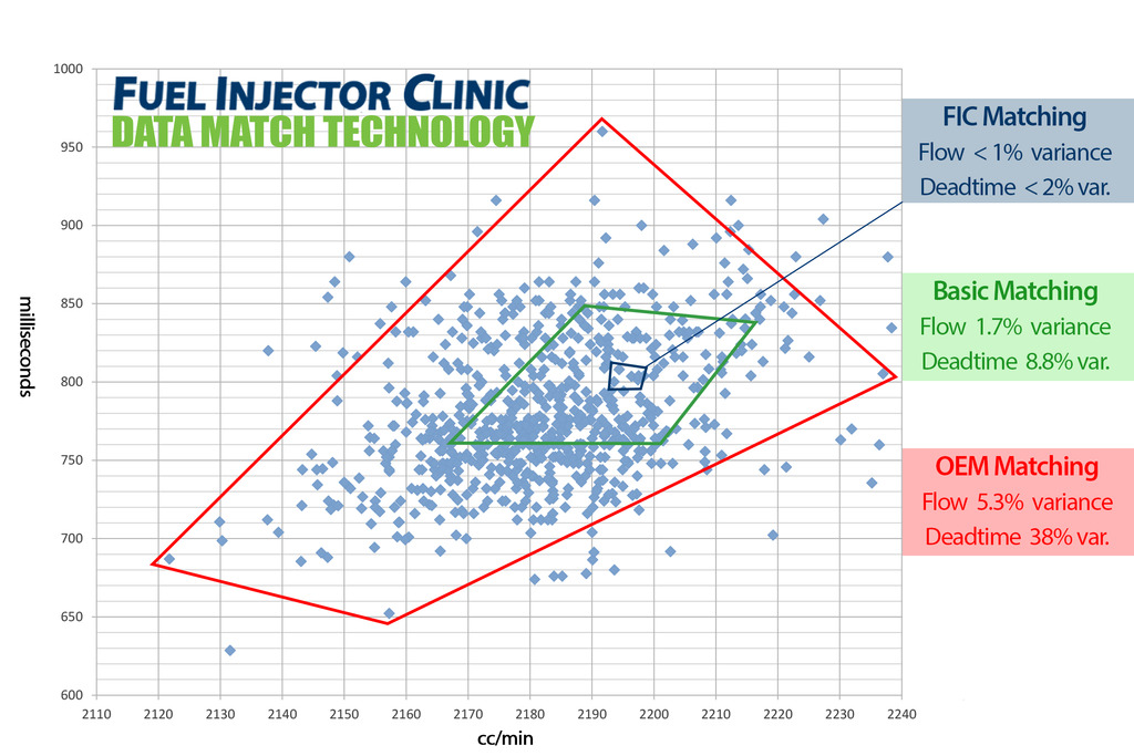

Beyond the base injector, there are quite a few advantages...
1) Precision matching the injector set by dynamic slope flow values as well as individual latency values (see chart below for how much of a difference this really does make).
2) Injector data for tuning purposes makes tuning easy and straightforward -- dont leave home with it!
3) Customer service and warranty. Ours kicks butt. Ebay and other price-point brands really don't have any.
This is a real representation of a group of high quality Bosch injectors at our facility. Without precisely matching them by both flow and latency values, your set of injectors could be all over the map, never even allowing for good results from even the best tune.
