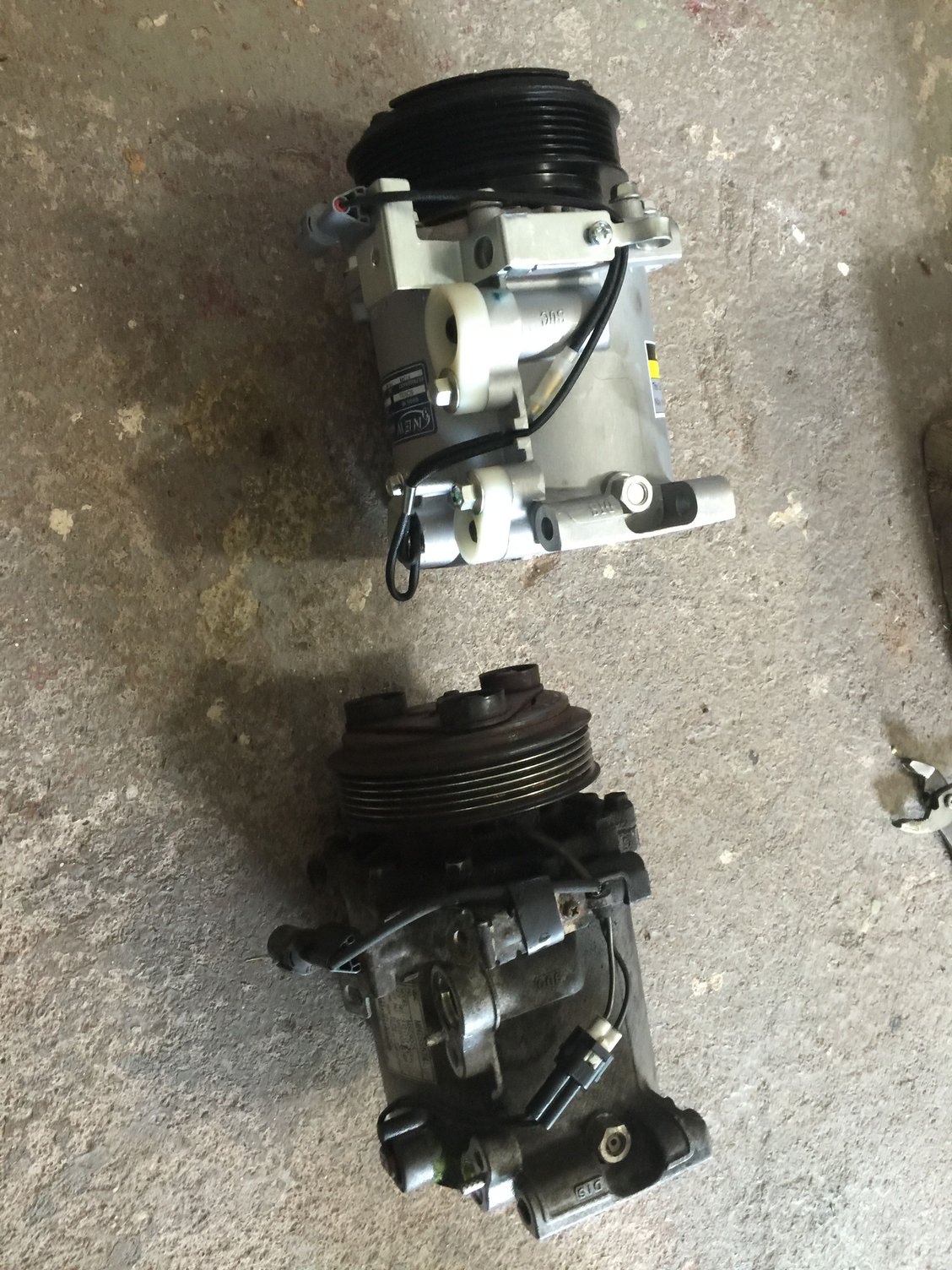

I just bought this last week:
http://www.pitstopauto.com/products/...ncer-co-11161t
$133 +$35 next day air shipping.
I installed it in about an hour and I never replaced a compressor before.

if that is the case i will be doing it myself. thats a good price, i did a quick searxh and a new one was about 200+
used was 99 on ebay
