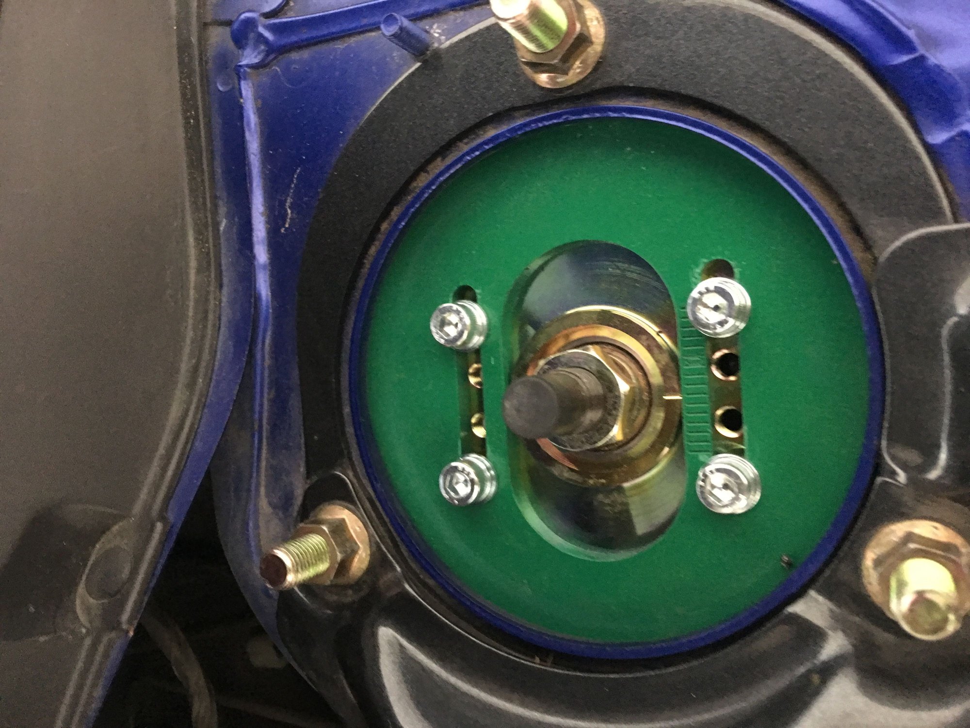

This the the driver side camber plate

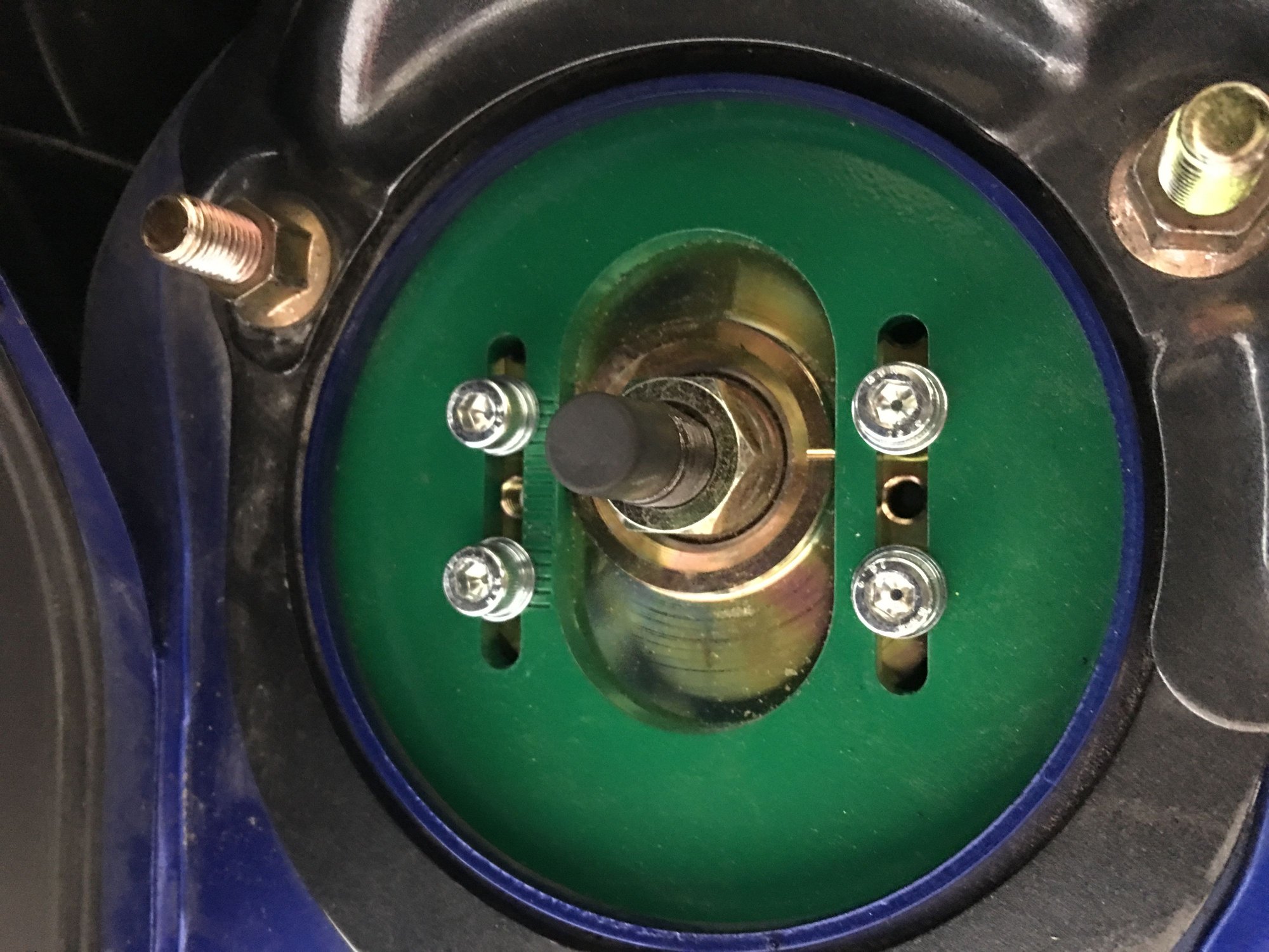

This is the passenager side camber plate, how come the 4 camber adjustment screw is different position from the driver side?

hi, I just went to do another alignment today one of my rear tyres got flated and need to replace, and then after the alignment I find out the both front camber plate screw is in different position, I can show you the picture

Hi Eddy
Not a big deal, but a good alignment shop would position the upper camber adjustment in the same position left & right. Also, looks like the allen headed bolts were installed in the avail holes
The allen headed camber bolts can be put into any of the those mounting holes (makes no diff other than its not even)
Next alignment, advise the shop to even out the upper pillow ball camber plates to side to side & install the allen headed bolts in the same holes left & right

Hi Eddy
oh I see thanks so much
so by you mean the headed bolt were installed in the avail holes, you mean they did that by purpose? What does that actually do?
Those allen headed bolts lock-in the camber settings. If they are loosened, you can slide the shock in the slotted opening adjusting camber
