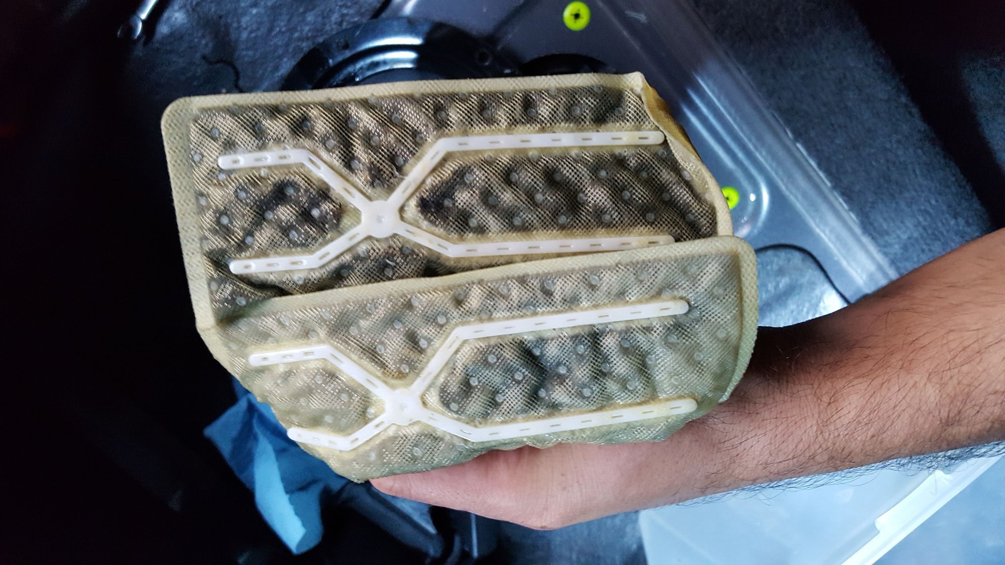

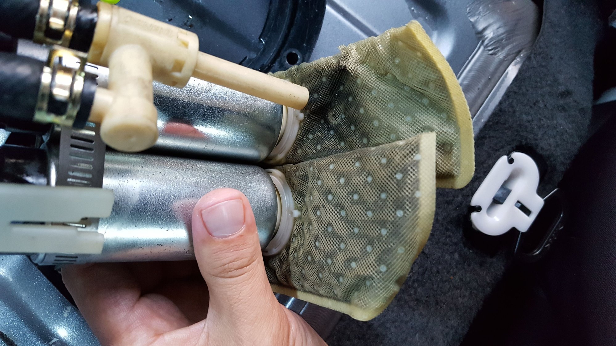

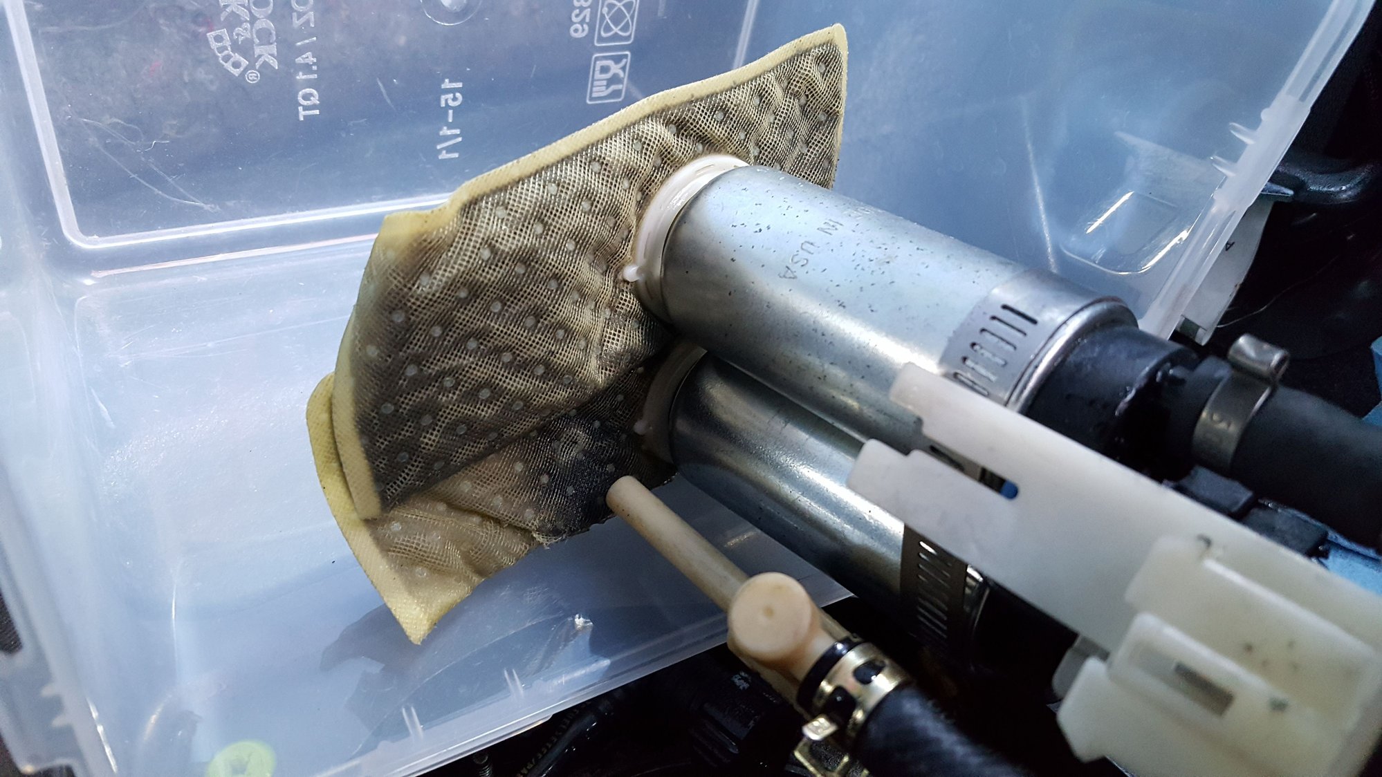

Recently I've been trying to diagnose the issue with my car. One of the last things I figure I check was my fuel pump housing. Can't really tell if it's clogged, but I can see a tear in one. I believe it's the secondary pump though. Since I have it out I would love to replace them but can't seem to find them. See pictures below
This is for the Walbro 255s
Thanks for looking

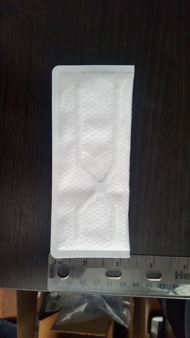

Thank you. I am going to measure it and see if any of them matches. I also sent an email to BR so see if I can get it through them.

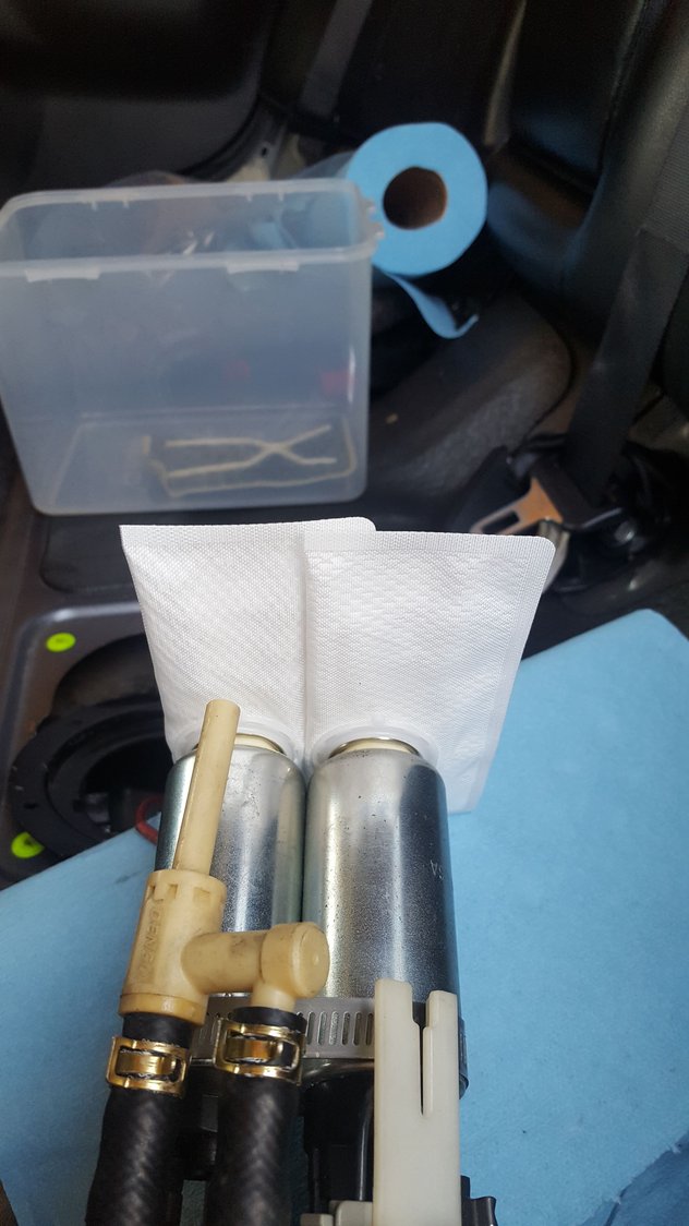

Just wanted to update this thread. I went ahead and ordered the replacement filters through Buschur. The old ones pull off with a little force then you install the new ones by pressing it down on a hard surface. Also I believe the ones shown on the above link is the same
