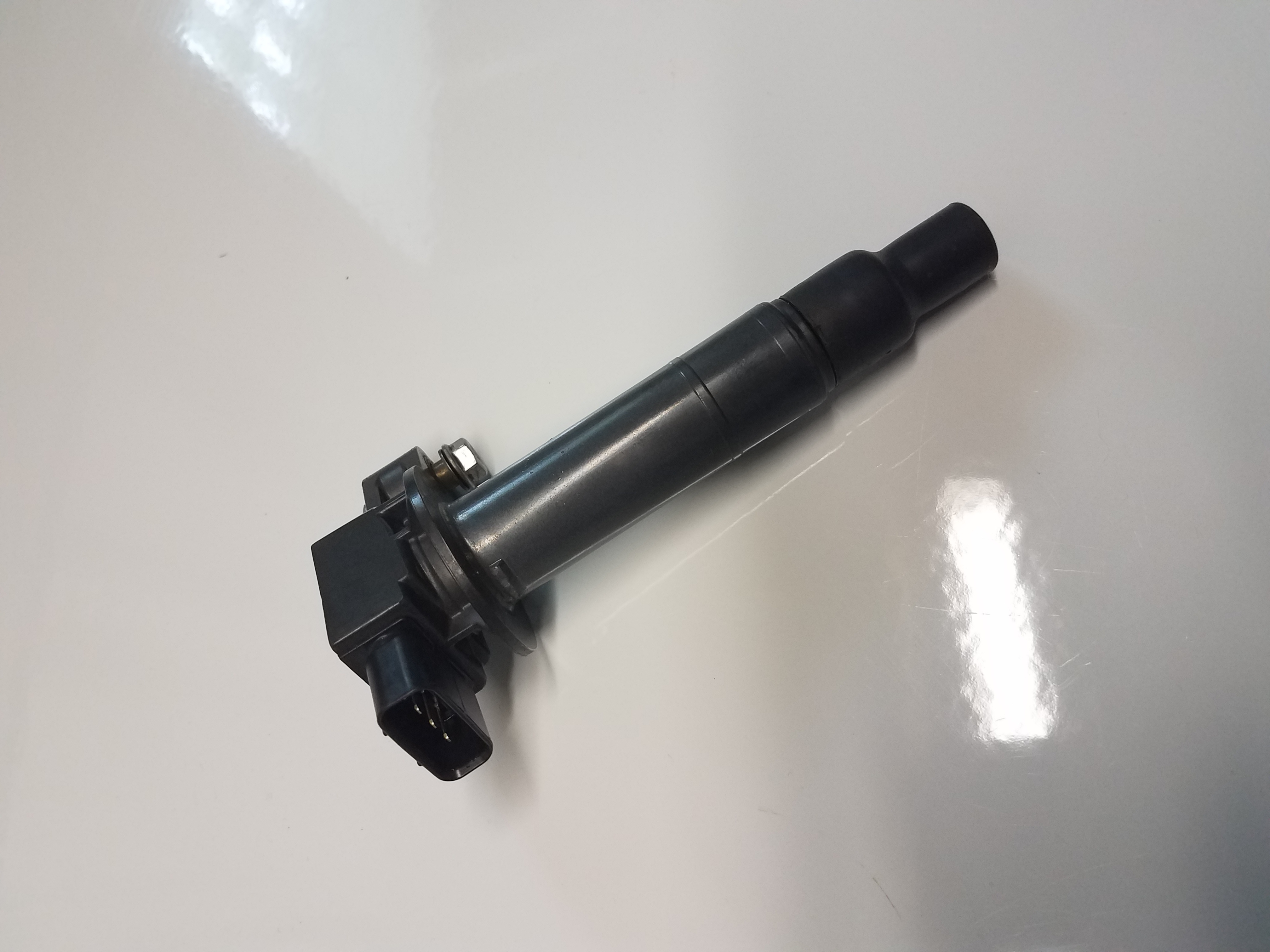

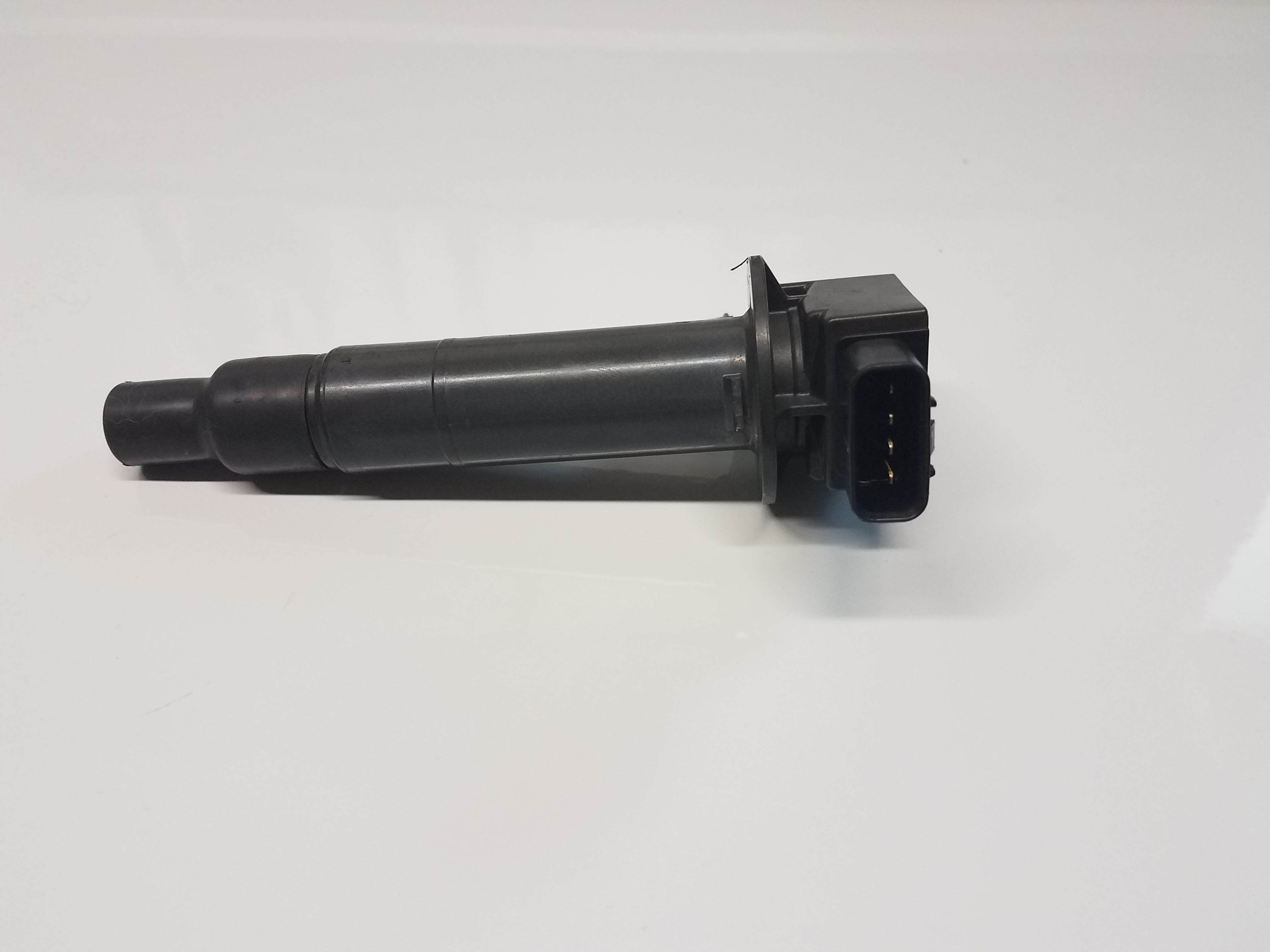

I have enjoyed many years from my current COP and the system has performed flawless up til now.
Due to an abuse that I caused, one of the coils has kicked the bucket!
I reached out to the manufacture - but they are 2 weeks out on new coils and I dont have the luxury of waiting that long.
As best I can research - the attached pictures(failed coil) are OEM Denso Ignition Coil 90919-02240 commonly for Toyota.
The only modification that needs done, is the weather seal needs removed, and the spring which contacts the plug needs stretched slightly. I would use the other 3 as references for this.
If someone can confirm this is the 02240 coil, I can get one in about 2-3 days.
Thank you in advance!!

Denso - Part #: 673-1306
The part number listed above is the Toyota part number.

Yes, the denso and toyota part numbers you listed are correct

Could be a knock-off...
I believe legit denso coils have the part listed on the side of the top of the coil.
Irregardless it is the same format/style.

New coil came in. Toyota part number as listed above. I did nothing to it but take the weather seal off the top, bolt it to my sparktech plate. Added a little dielectric grease to the coil. Dropped it on.. and took it out.
Runs like it did before i shorted the old coil out.
If more die, i'll continue to replace them with genuine Toyota coils.
