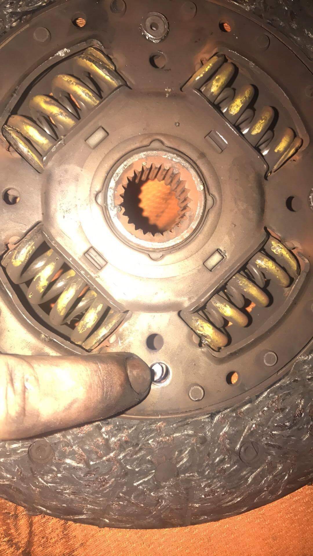

Update: The clutch disintegrated. A spring came off the ACT and the rivets broke.
Installed Exedy Stage 1 HD (05830HD) and a monoloc for good measure.
Now the car won't really engage 2, 4, or R. It does actually engage (90% of the time) and will drive in those gears, but it feels like it only shifts halfway into the gear. As though it's an extremely short throw or that the linkage isn't fully engaging.
When the car is off, it shifts fine. Thinking either clutch isn't disengaging (only why would that only affect the bottom gears?) or that the linkage wasn't installed properly when reassembled..
