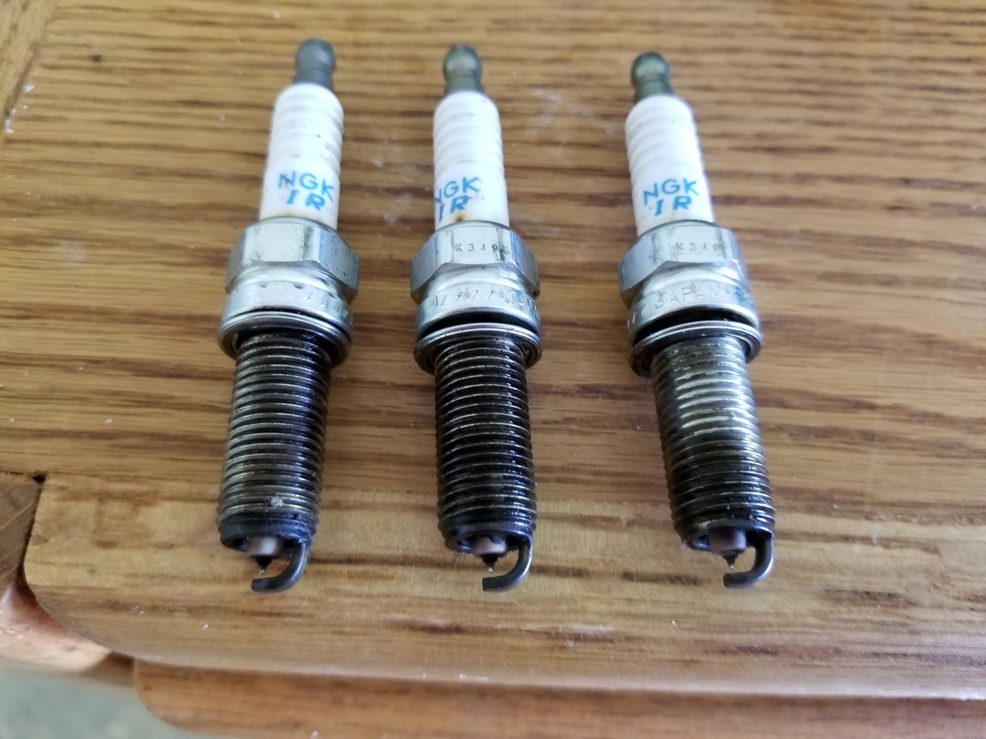

Photos of plugs?

Cyl 1, 2, 3. 4th looks similar. Amazon decided to send a plug a day late.

Note: I did spray them down with carb cleaner to check them before my new plugs got here. This was after 20 miles or so, same look as before I sprayed them down.

It's a bit hard to tell from the photos but the threads of the plugs look a bit oily.
Maybe in a week or so, pull out the new plugs and see how they look.
That's if you're still driving it.
I'll take a guess that it's rebuild time.
