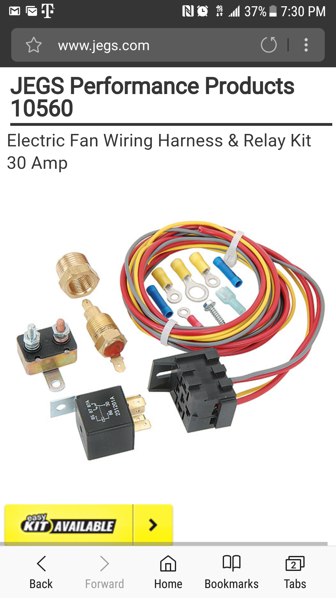

Does it have a thermostat? Those fan modules are notorious for going dud. I would start with a temp/fan switch. And a module. Or you can delete the fan module and add a relay and temp switch.
