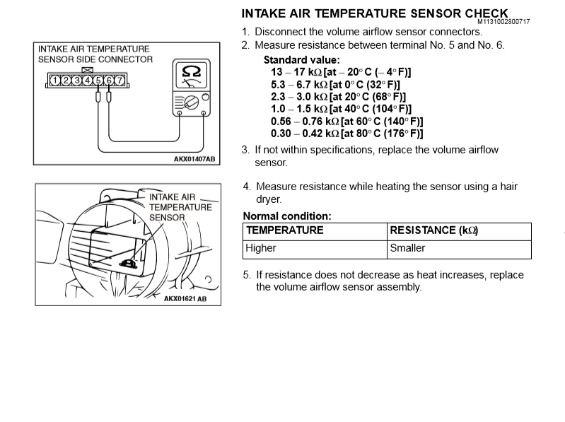

SoI have this DTC P0112:IntakeAir Temperature Circuit Low Input code. Plug looks fine wires look fine. Is their a test i can do? What should i do? Car runs like complete crap and this is the only code.

Here's the service manual diagnostic.
Did you check the sensor probe itself? Maybe there's oil or other garbage on it that you could clean with MAF cleaner?
Do you have evoscan? If so, you could read the value there. If it's zero then you may have a wiring problem or a dead sensor. If there is a value and it's low, I would lean towards a sensor with one foot in the grave.

about 69 degrees it got 2.2 ohm suppose to be 2.3 to 3.0. Tried to clean it code still present. Would you call the maf bad?

Not from that.
