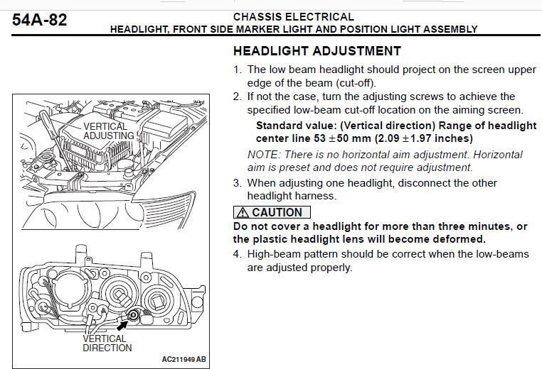

Can someone tell me how to adjust the HID’s on the black housing evo 8 headlights. Or share the link to a thread that shows how to do it. Plz and thank you

Here you go (note: There is no horiz adj (vert only)
