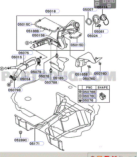

do you happen to know the part number so I don't have to look it up? What tools would you use to get it off without cutting?

Heres a EvO9 layout. Let me know which item no. you need & i can call out the no. for ya
I think the item he cut was probably 05016. The fuel filler neck. But maybe he will chime in and confirm. I am just trying to be prepared for when I do it and document this for anyone in future.

05015 and 05014 in the diagram above are what gave me issues.
05015 = oem part number MN106218 (cost around $16)
05014 = oem part number is MN106217 (cost around $60)
To anyone dropping the tank, i'd order both of these items.
05016 comes up as: Mitsubishi MN120030 (still apprears to be an obtainable part)

Ya I needed 0514. I ended up buying the snap on hose pick set item# SGRHT6BR. I probally could have saved the hose if i had these to begin with lol.
