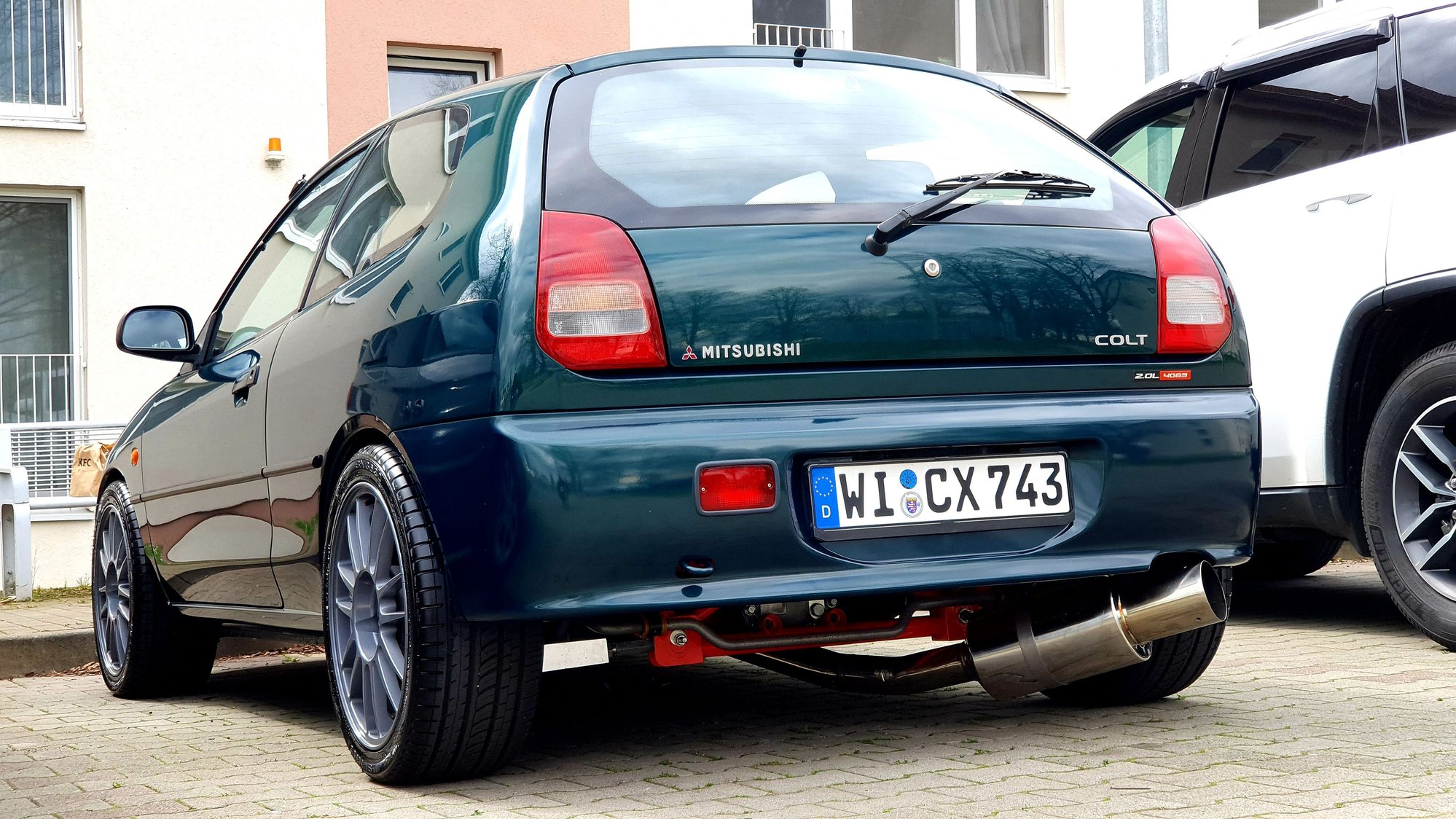

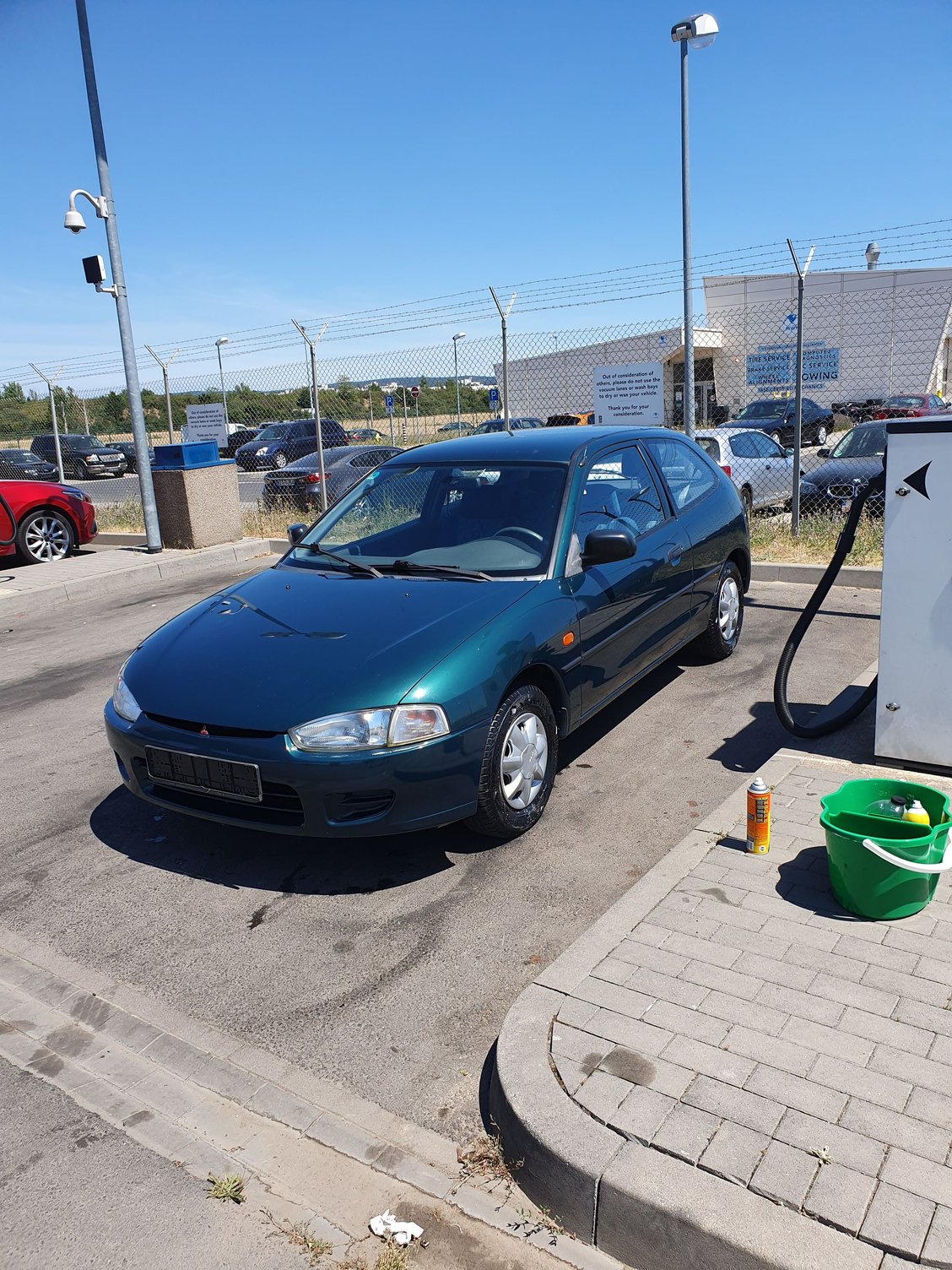

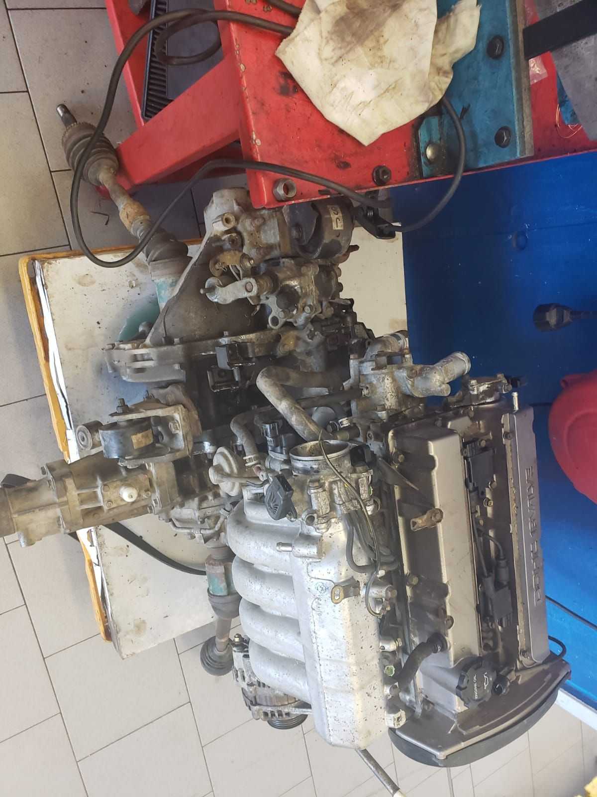

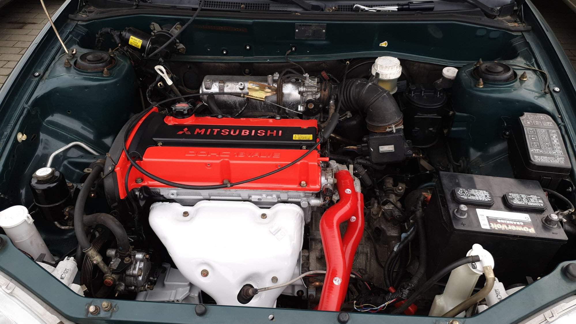

Hi,

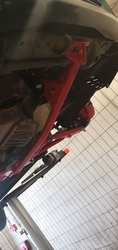

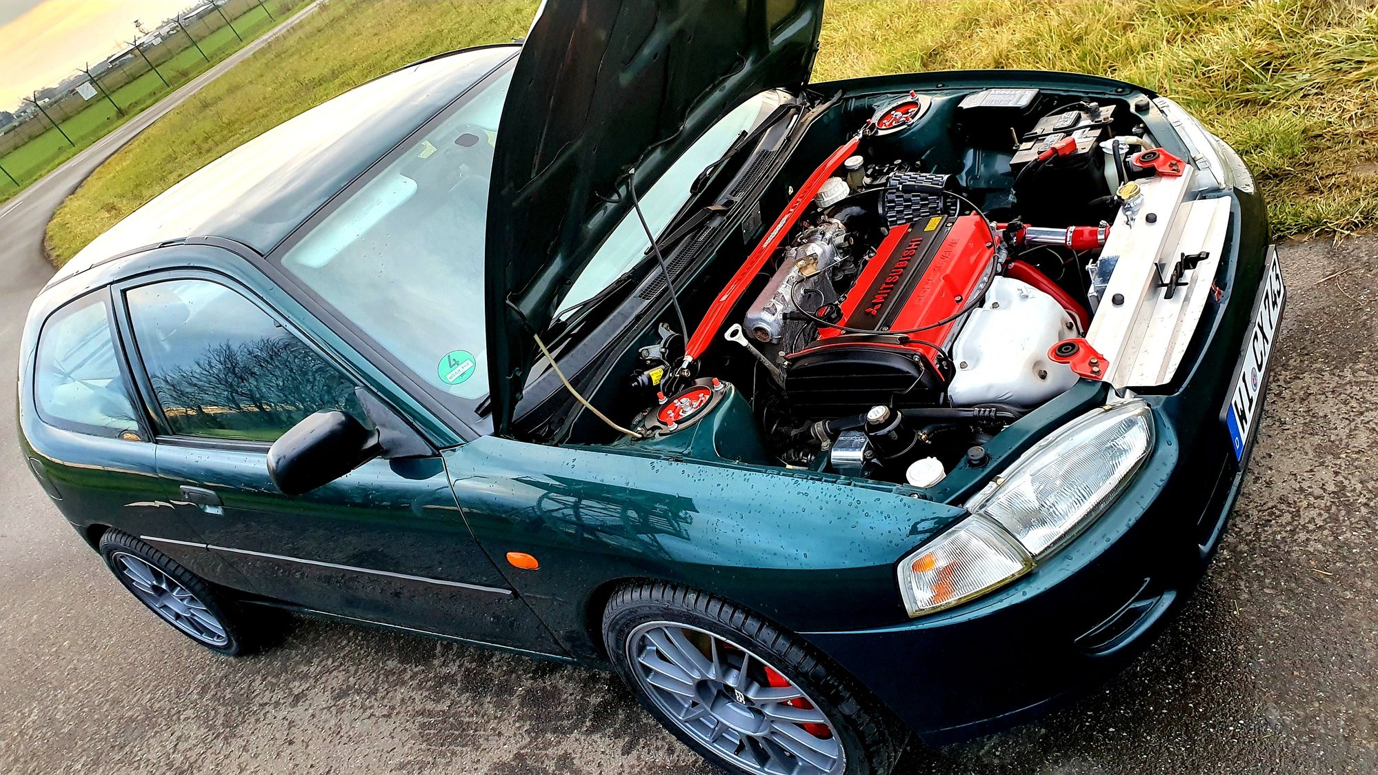

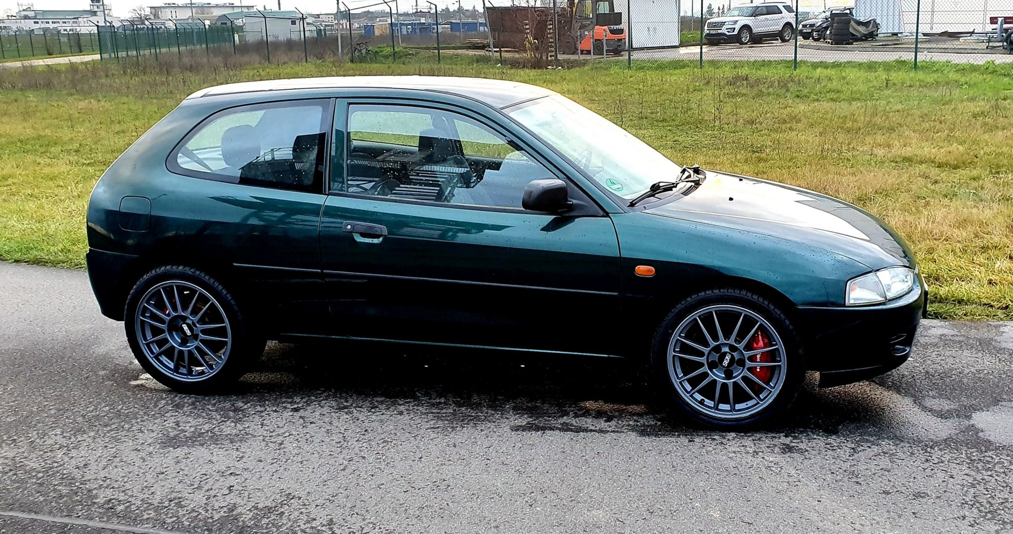

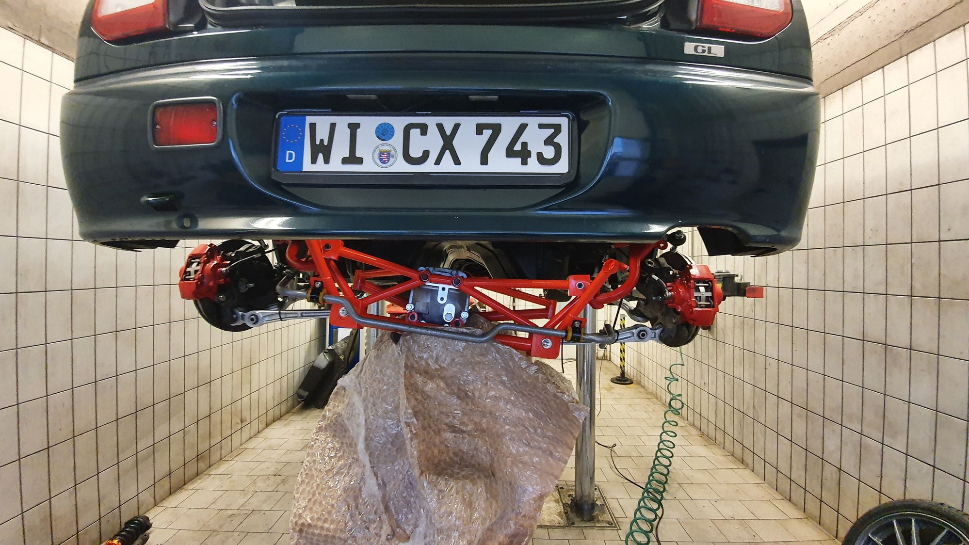

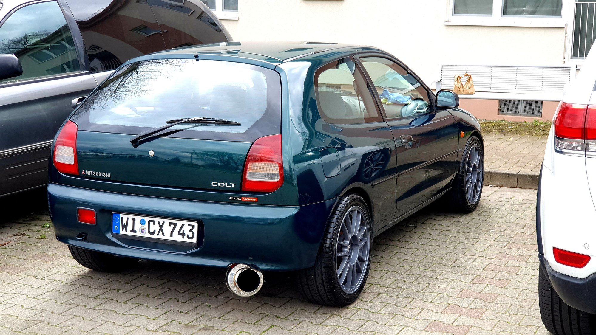

this is my colt evo project
Oem
4g63 5mt awd

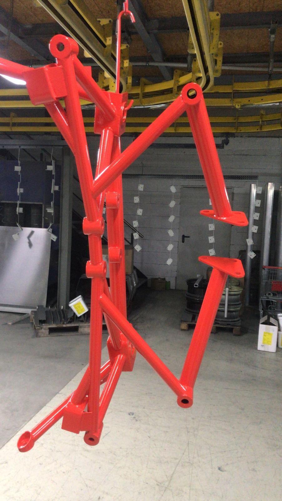

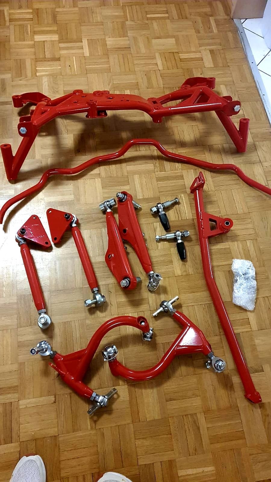

A little of powder coating!
The yellow color have been replaced to red like valve cover.

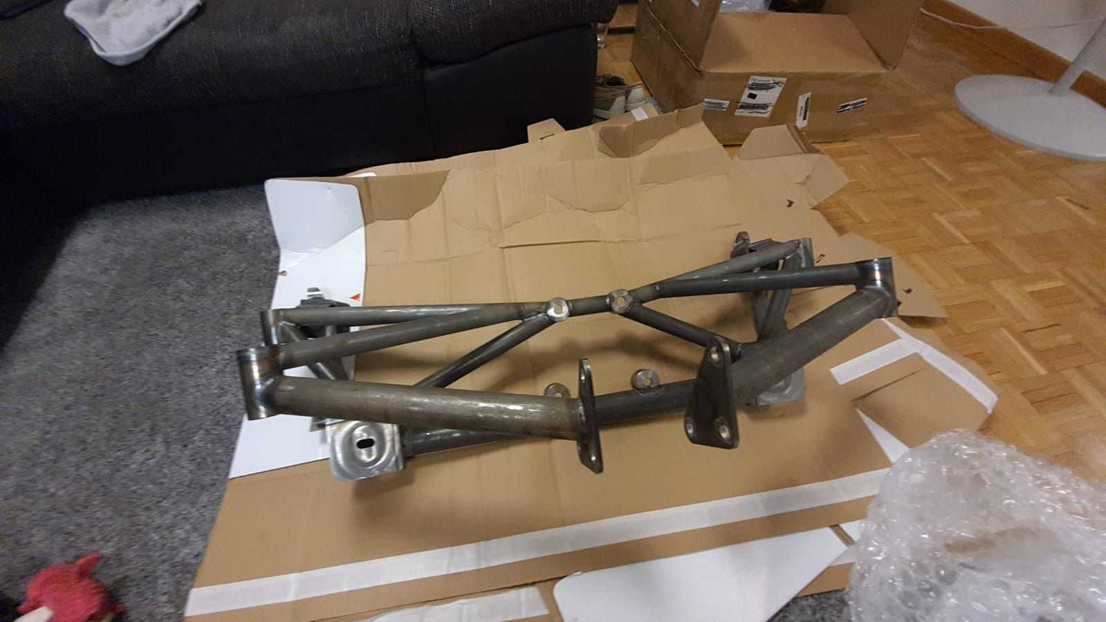

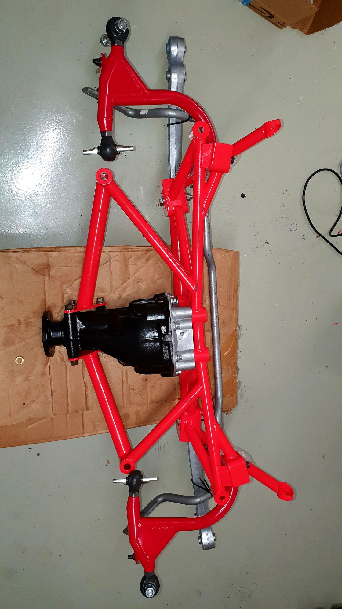

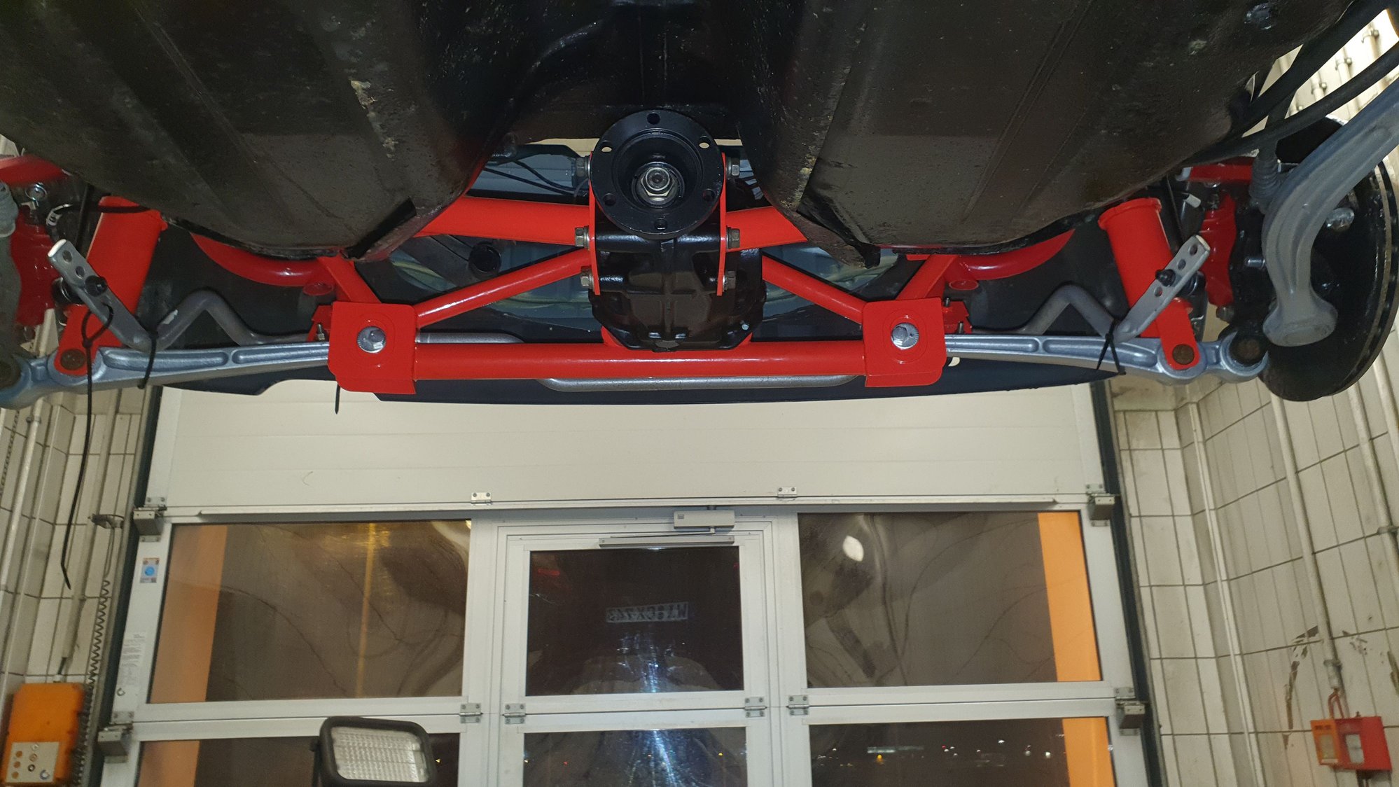

Rs chromoly rear subframe

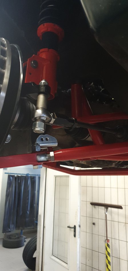

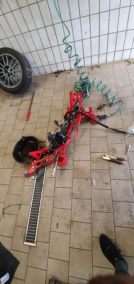

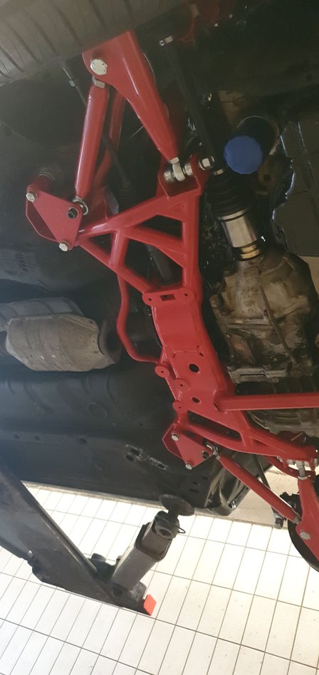

Evo 4-6 front subframe with evo 7-9 middle part to fit evo 7-9 transfer
Almost ready for install
Frnt subframe installed
Tie rod extension

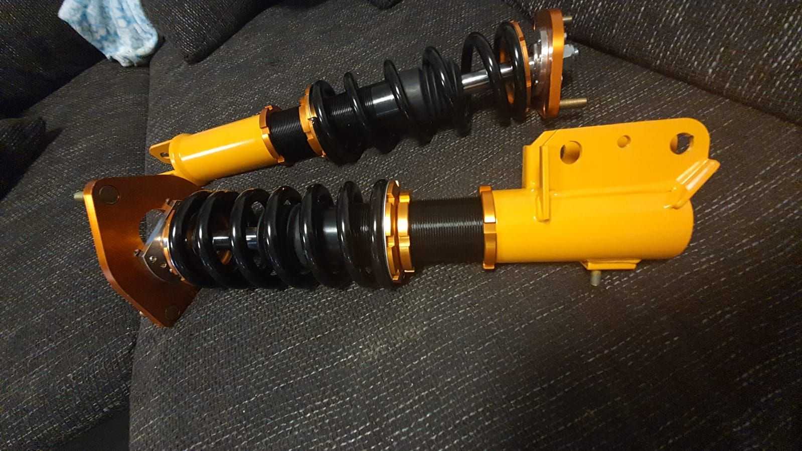

Evo mr wheels,brakes and suspension.

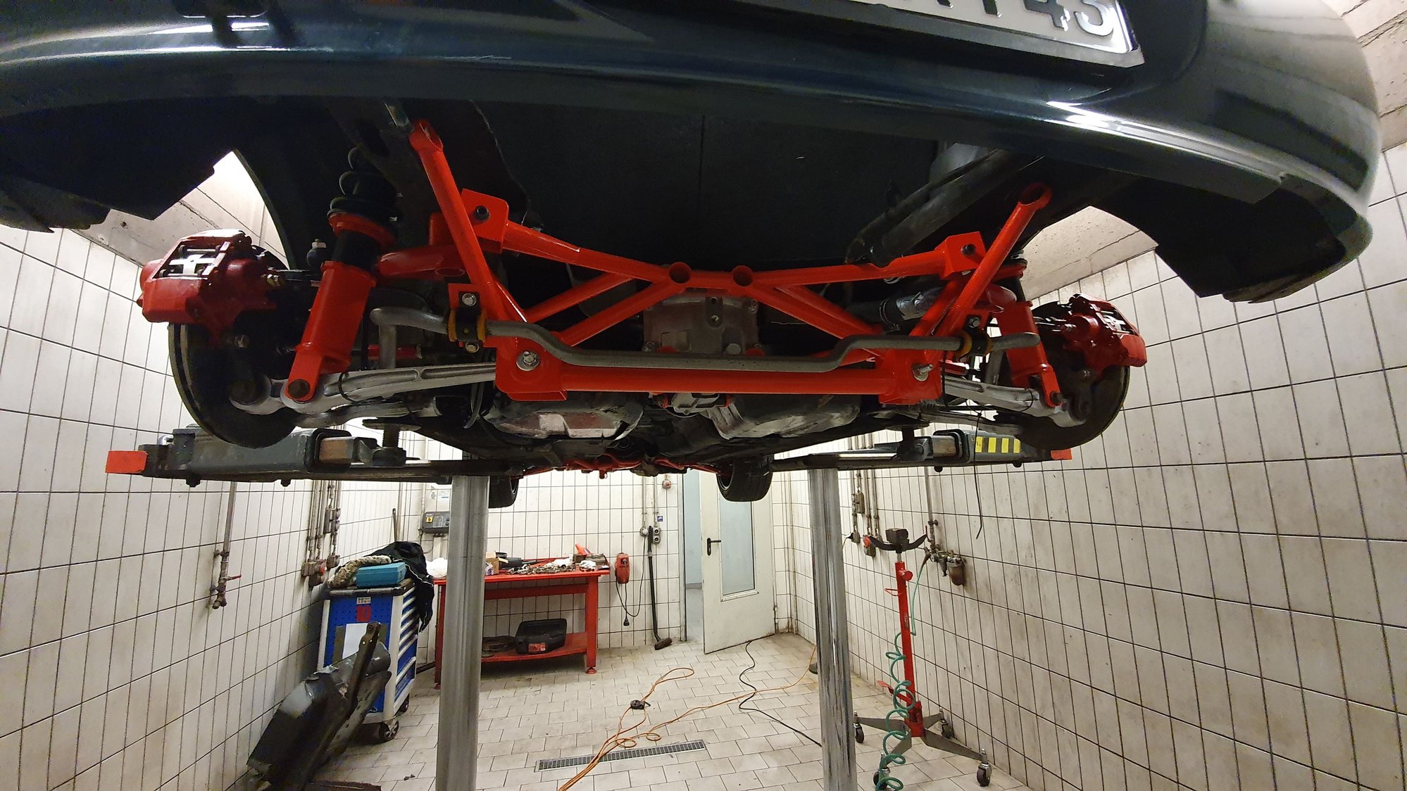

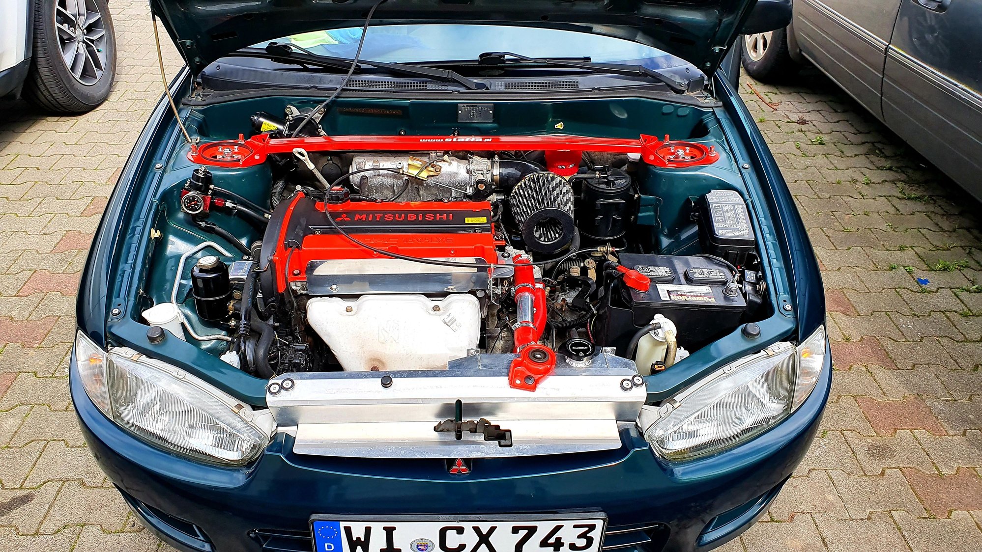

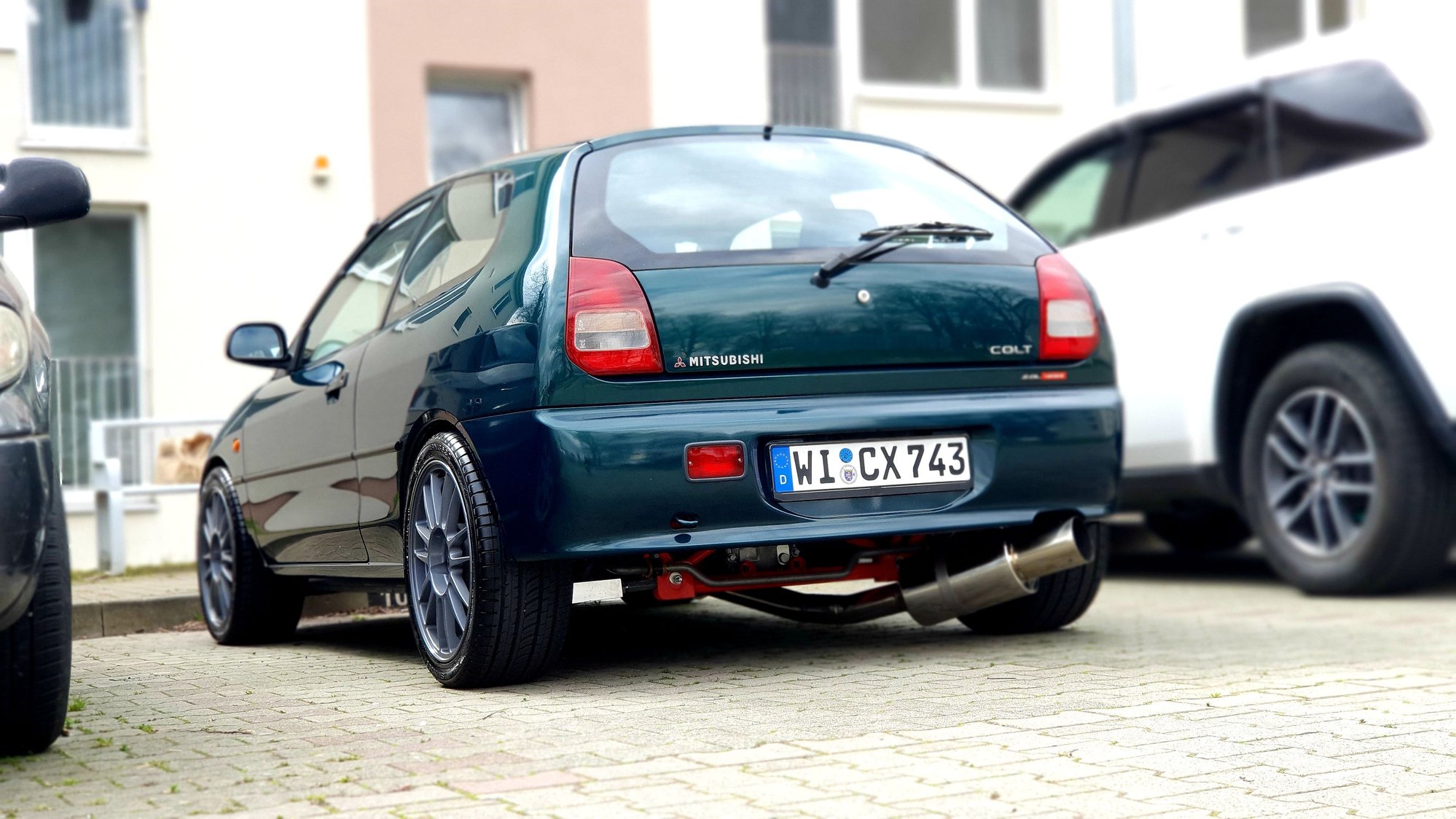

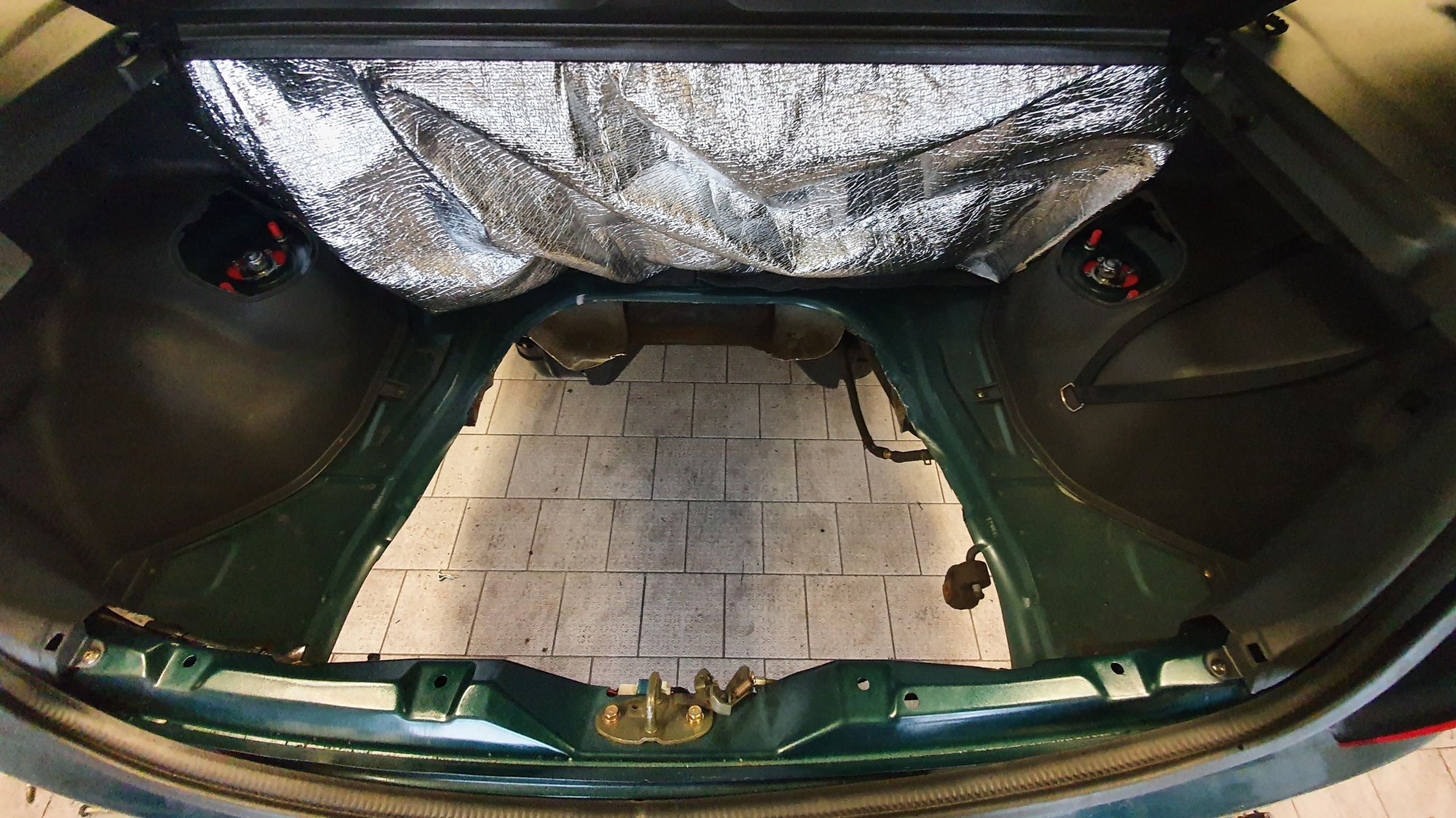

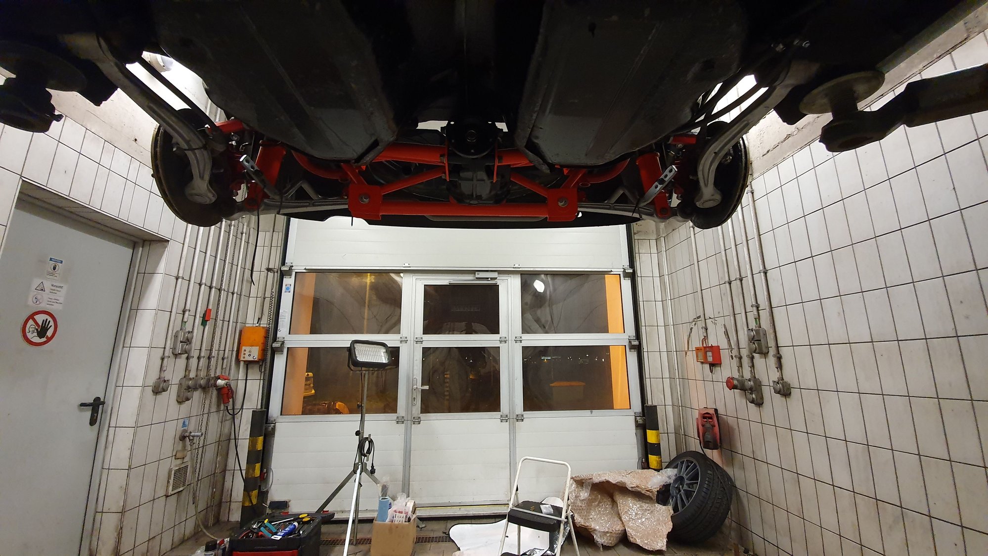

Some updates!
Turbo coming soon!😬😬
Awd system done!✅
Rear subframe with e" exhaust. There no space back there🤷‍♂️
