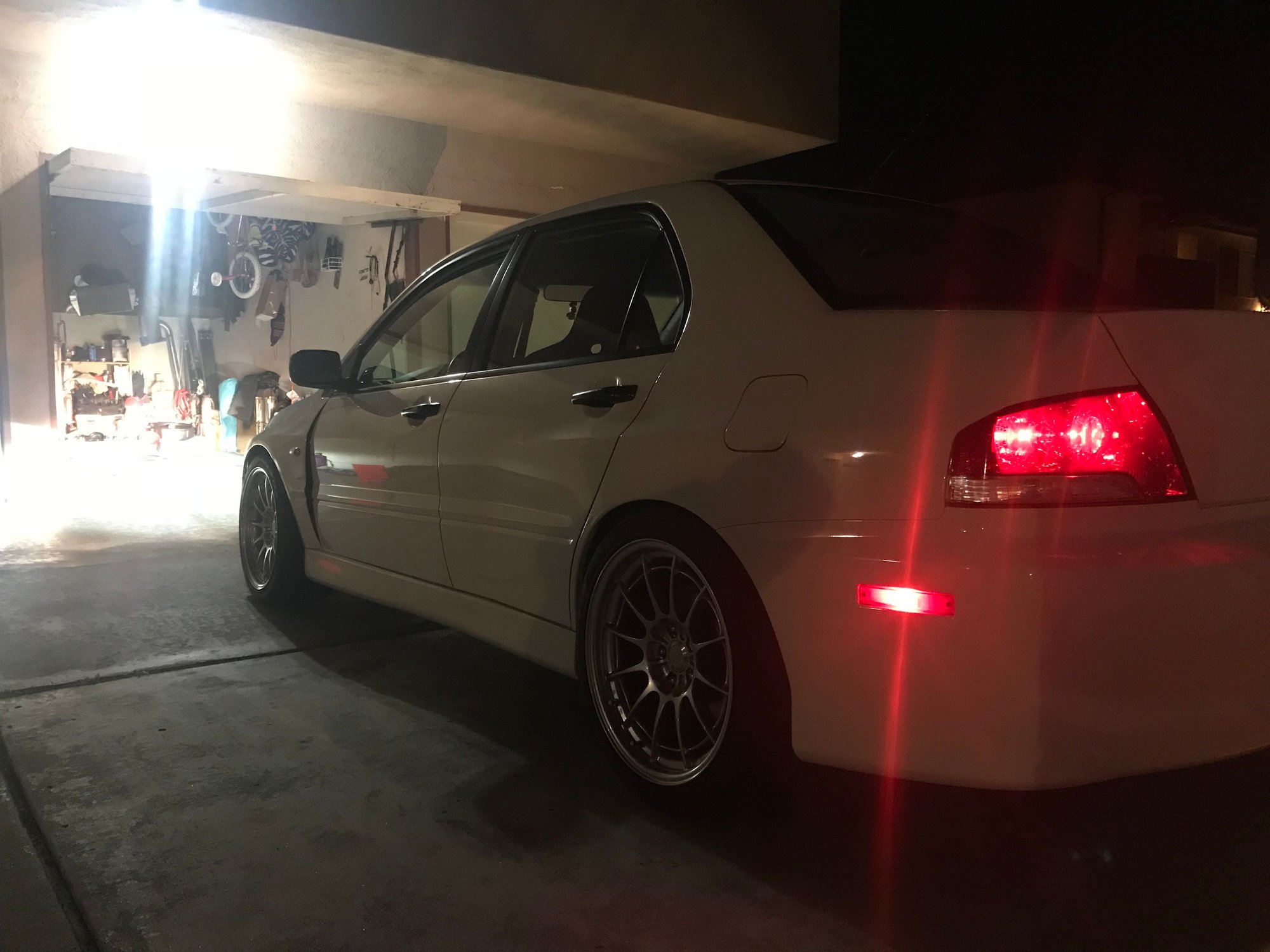

What’s up guys , haven’t been on here for long. I’ve been running on nt03s 18x9.5 +27 offset , 10mm spacer up front with extended studs with 245/35/18 Hankook Tires. It’s been a while and I want to run on some meatier and aggressiveness tire thread. I want to go with falkens azenis rt615k+ . Any ideas of what setup will be suitable? 255/?/ . I’m also running on 10mm carbon fiber fenders .

From my experience with the same wheels setup. I’ve run nitto nt05 and now on advan fleeva, both in 256 35 r18. You will need to either do the fender/spacer mod or wider fender you will also need to hammer down the seams in the rear of the front wheel well. And quite a bit of rolling the rear fenders and pretty aggressive camber.
