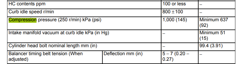

Hey, welcome to the boards @Thatkid385 & thanks for posting. Heres the compression spec from the manual for reference. How many miles on this motor?

Yep, many hard miles im sure. Sounds like the rings & walls are well beyond the spec?

The temp spec is this. Imagine if this shop did the check on a cold engine?
