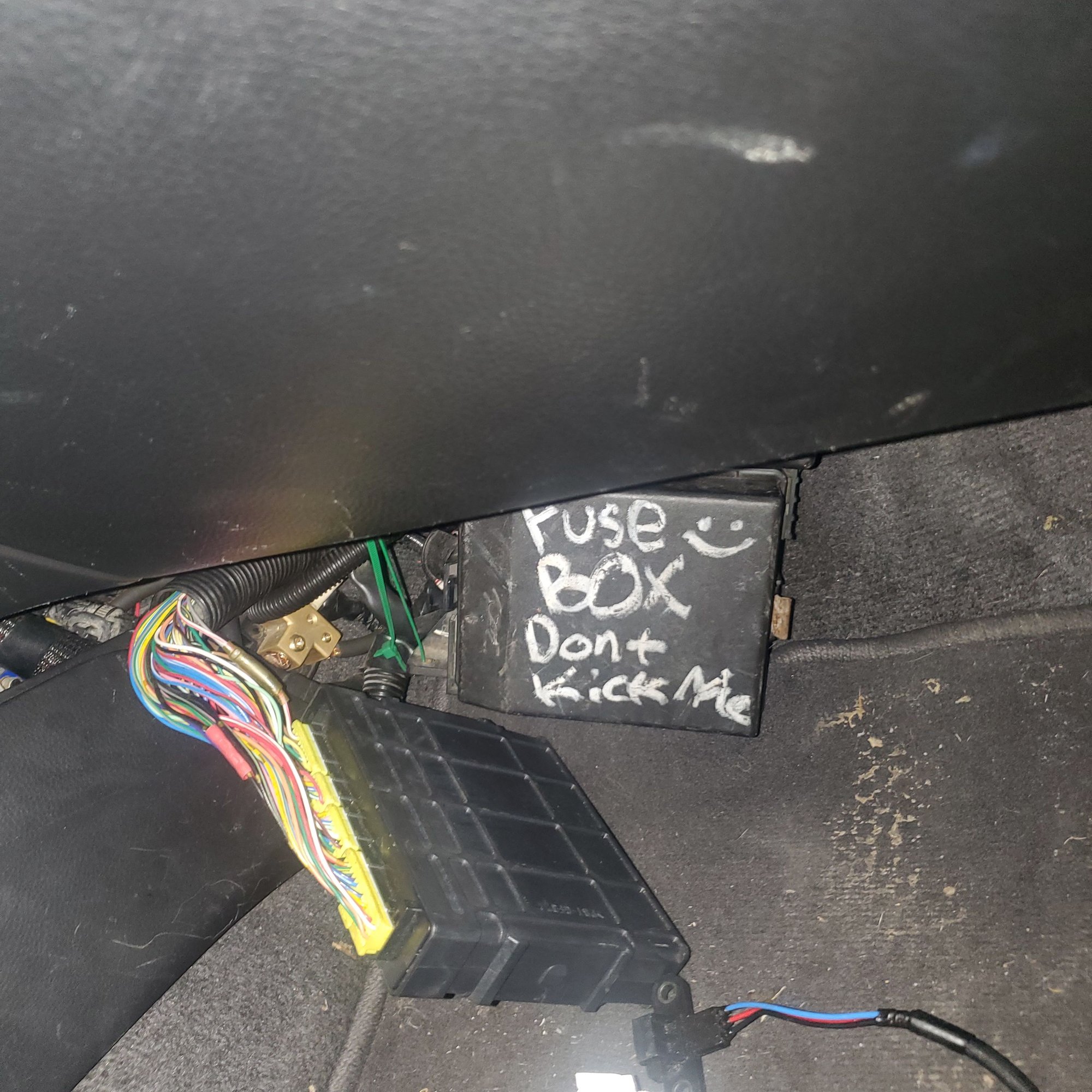

I took my evo to a friend of a friend's for some diagnosis, long story short. He figured out the problem but forgot to put my ecu back.
I've been trying to figure out where it goes ( I know it goes behind the glove box, attaches to some sort of bracket) but no luck. Maybe he lost the bracket?
Can someone on here maybe post a picture of how it's secured in your 8/9?
that would help wonders. Thanks

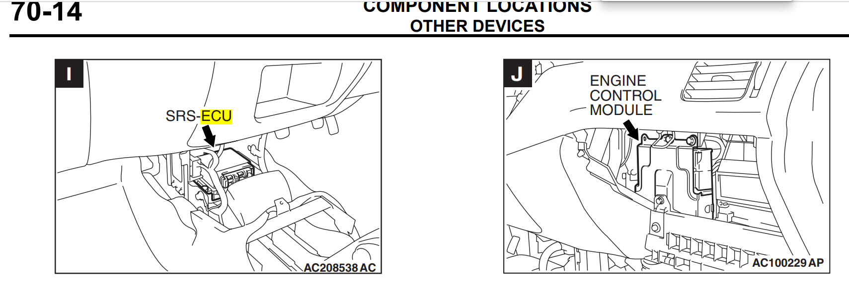

Heres the manual: Group 70 (J)

looks like your missing the metal bracket that clips to the ecu... then bolts behind the glove box.
or maybe its still bolted up there.

2nd image here is the stock location and where the bracket you seem to be missing bolts too.
