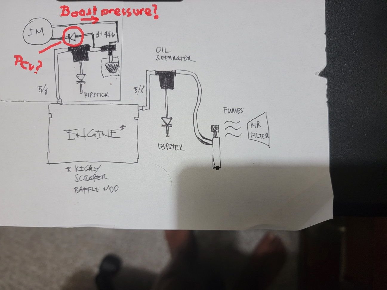

Originally Posted by krys88
Thanks a lot, I learned something new. Isn't pcv valve make restriction? Now without pcv my exit is 10an but with pcv its going to be much smaller. It is smoking only on idle so it would make sense to put pcv back in the car.

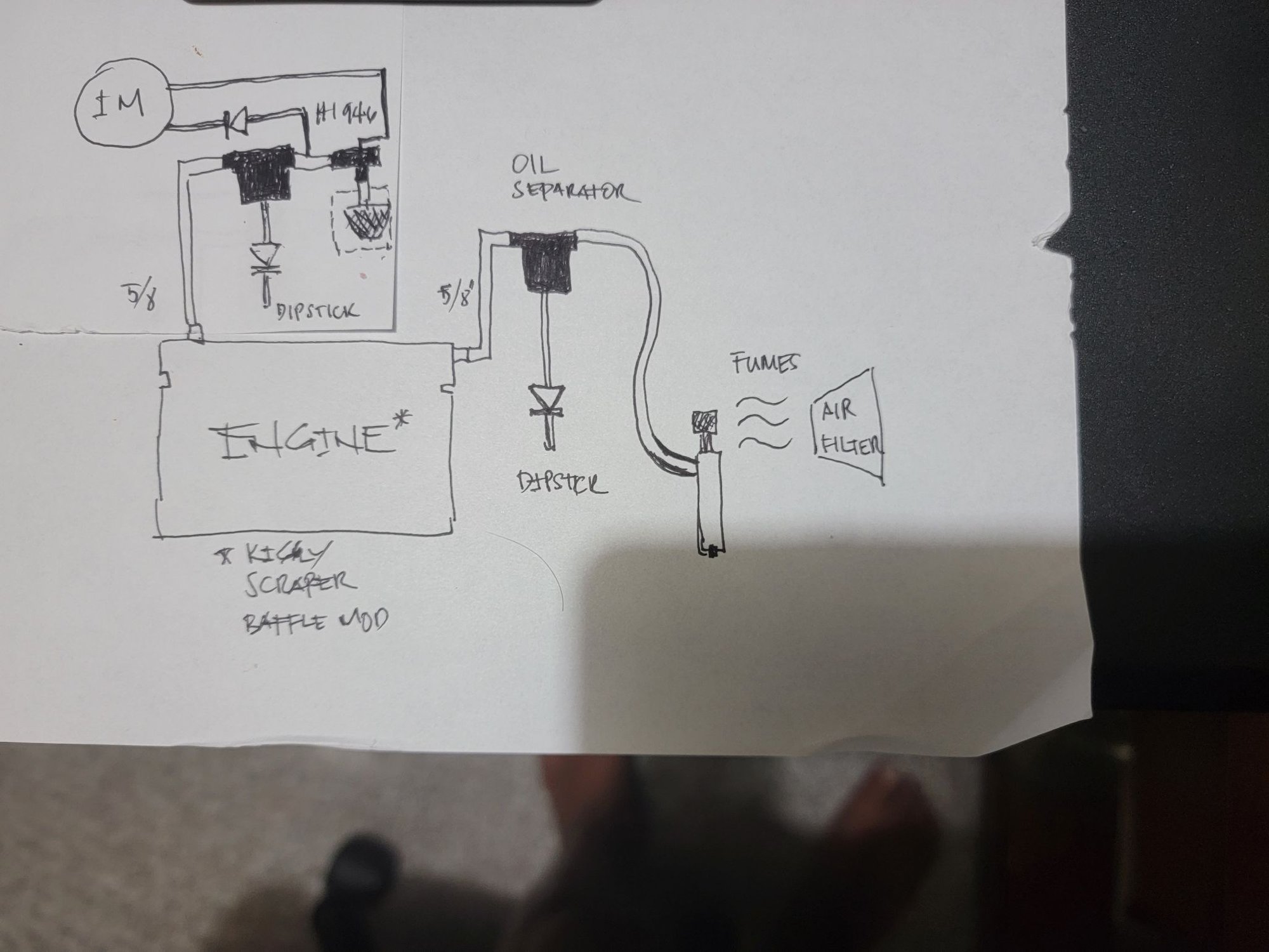

well i'm not sure about your set up. there are 2 ports, 1 to pcv, 1 to intake...only the latter is for pressure relief. some people with lots of blowby use both to relieve pressure... guessing thats what you have. I needed both too so I made the ports bigger and made the pcv side work for vacuum (suck in moisture) and boost (full WOT blowby)... that heater valve closes the path to the breather in vaccum state so the OE pcv works.
I updated the diagram since i made the pcv side maintenance-free (drain-back also)
Ok so my setup i very simple. I get rid off the pcv valve on the back valve cover and I replaced it with 10an and hoes going straight to catch can. On the side valve cover breather I have 6an with hose going straight to the catch can.
On you setup is this red circle that I marked is this pcv valve? Also how about if you boost isn't boost pressure going back in this line where I draw an arrow? Thanks
red circle is pcv, correct. WOT blowby uses the 5/8 fat hoses. the line you marked is just what opens/closes the heater valve.
heres the WOT flow for the older diagram
Ok thanks a lot! Let me ask you a question. If I install some pcv or one way check valve, and on idle and cruise whenever car is on vacuum the vapor/water will be sucked to the intake manifold. It this ok for the engine? I noticed that my side went is smoking a lot not the one where oem pcv is going. The back one where oem pcv is going It is not smoking as much as side one I dont know why. I can install pcv or check valve and route it to intake manifold but car will suck a lot of water on idle to the engine.
its fine, thats what the original motor does, just use a genuine mitsu pcv valve. it just lets a tiny amount of air thru. it sucks dry air thru the maf, into your crankcase, to your manifold, eventually taking some crankcase wet air with it . i tested air intake without the maf and the difference is very little.... definitely better than letting oil go into my intercooler
air pressure will take the path of least resistance. your smokey vent may have a bigger port/hose. plus the crank's rotational direction might be promoting more pressure to that port
