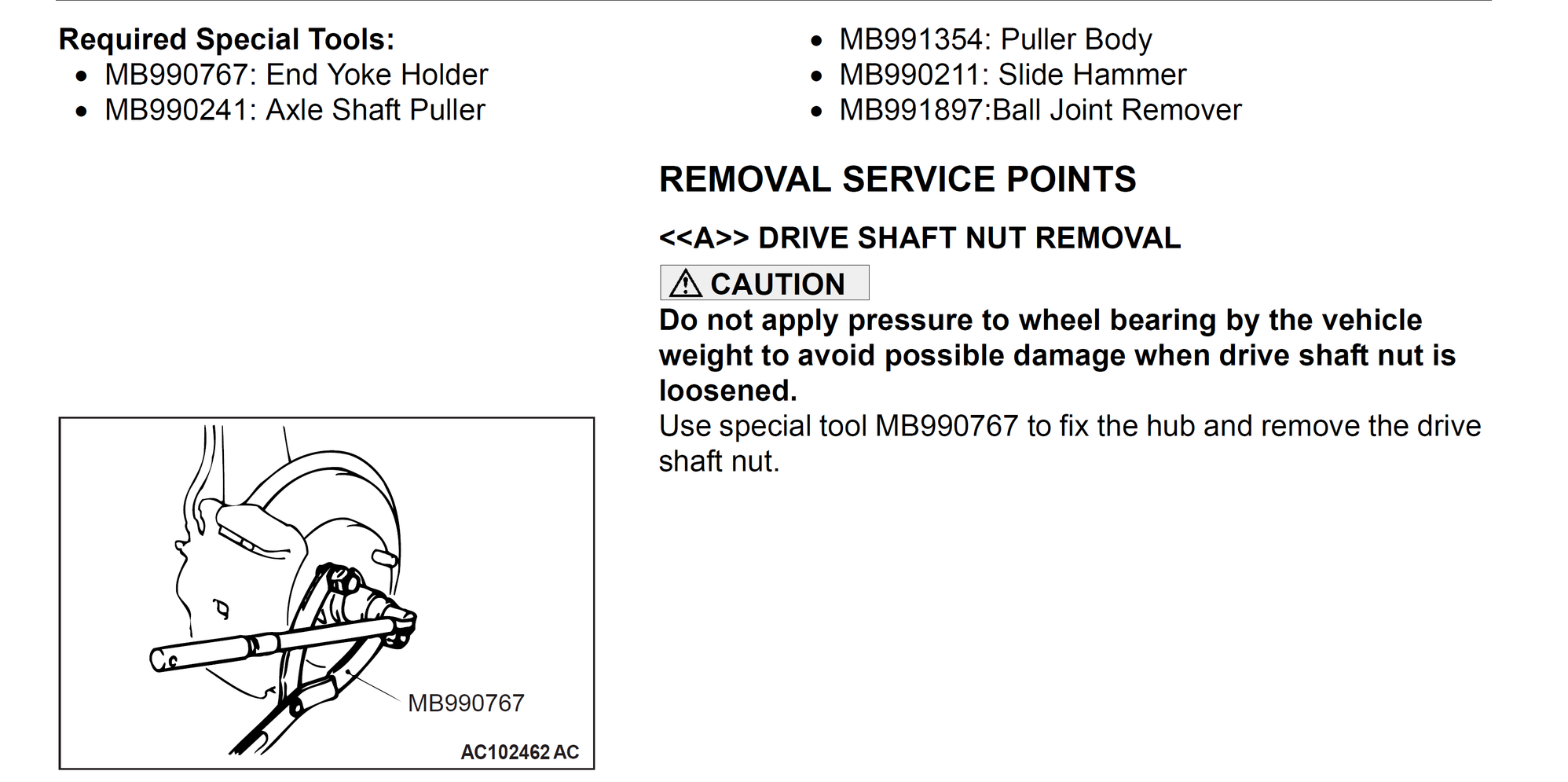

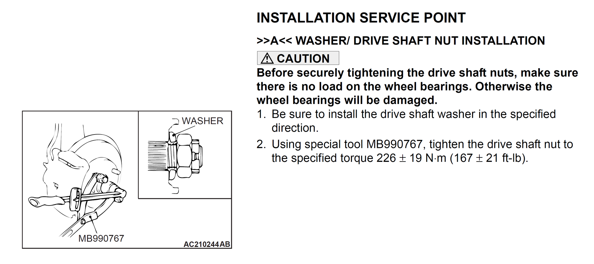

I might be misunderstanding what you guys are talking about, but you cannot load up the wheel bearings without the axle (or something) installed clamping it together:

right. that's why i want the splined/threaded end of the axle only in order to tighten the axle nut. hoping the rear wheels will spin fine at highway speeds when using the FWD dolley. whatchuthink? help me mcgyver this thing

I think that would work fine. I've even considering trying to just use some washers and a big bolt to clamp it together in a pinch. Thankfully I haven't had to cross that bridge yet. I have ruined a wheel bearing by not having anything in there. Learned that one the hard way.

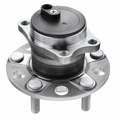

hmm wonder if the FWD rear hubs fit? that would be awesome. Its probably available anywhere
https://www.ebay.com/itm/40258683153...Bk9SR5qc-qb8YA

That might take some modification since the bolt patterns are different if I am not mistaken. If you want to convert an Evo to FWD I believe its easier to dissassemble the axles and use the parts. What I mean by this is you will use the front outer axle cup to secure the front wheel bearing. Then use the inner axle cup in the transfercase. Maybe you can modify the inner axle cup and fill it with lead or weld a plate to close the inner axle cup. That is merely to add some weight to keep it installed in the transfercase. It should be balanced since its rotating which is the same for the front outer axle cup.

I think the AWD 2G uses the same wheel bearing in the rear as the CT9A. So maybe the FWD 2g rear bearing will bolt up in the rear of evo. Pulling the hub is more work than just using stubs from a CV though.

the bolts holes are 17mm hex so no bueno
